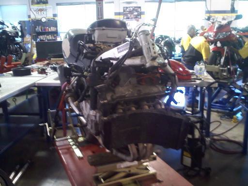

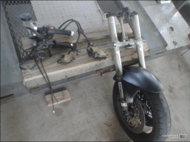

So... i bought this beauty of a 95 cbr600f3 after someone had wrecked it, sold it to another dude, sat for a year, and then made it to me for $500... came with an extra set of forks that weren't bent and another tree, a windshield, road rashed fairings and mirrors... well i got to messing with it and the fuel pump was shot, rim is bent VERY nicely -_-... and the forks were off of an f2... so i bought a complete 954 front end for the same price i paid for the bike...

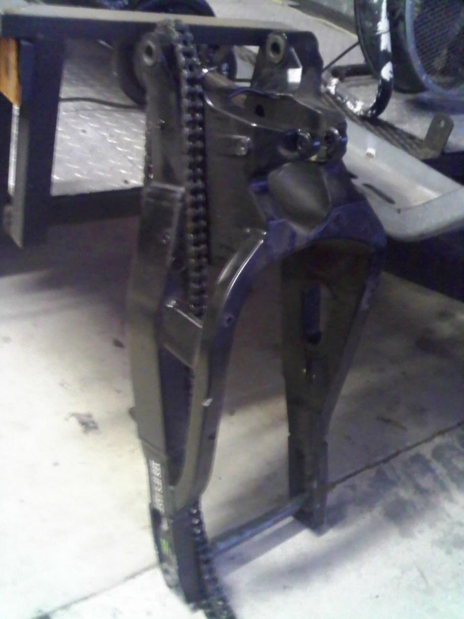

On to present day... i've sold most of my extra f3 parts... ordered an aftermarket chinese fuel pump, bought an 8in. extended 600rr swingarm (which has been done before... Fathead_03's 1996 CBR build "to be named" - Custom Fighters - Custom Streetfighter Motorcycle Forum )
i went to put the inverted forks and tree on today and the F3 has caged ball bearings whilst the 954 has tapered rollers... both sets were ****ty anyways so we busted off the bottom tapered bearing on the 954 trees and i'm going to order an All ***** tapered roller bearings and races kit after i sell the goofy *** headlight (looks weird without any fairings
this brings me to the question portion of the thread...
What would be a cool looking/ well lit headlight to use?
i was thinking about getting the Danmoto 180 dashboard/ gauge cluster ( Danmoto 180 gauge cluster - YouTube ) because i'm not wanting to keep the gigantic fairing stay and stock gauges... thoughts on that?
and when i get the aftermarket gauge cluster what should i do with all the gauge wires?
and lastly, what are your opinions on cutting the muffler?... it has a D&D something on it which i took of to clean because it is INSANELY rusty, i saw a ton of threads on here but not one using a D&D
i realize it's A TON of work... but i'm young (20) and have ambitions to keep this thing for a ling while

got the 954 front end on today
Attached Thumbnails 1995 F3 I decided to turn into a fighter (in progress)-0420020831.jpg
