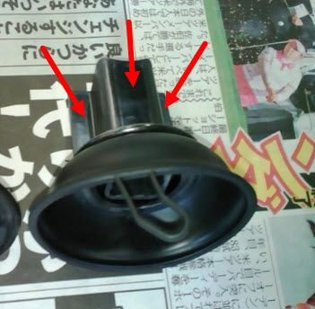

you have to clean the diaphragm slide itself (not the diaphragm). i use petrol. i'm afraid to use carb cleaners on rubber parts
also make sure these holes are not clogged. when you put a blower from the top side of the diaphragm you can feel the air coming out from these two holes.

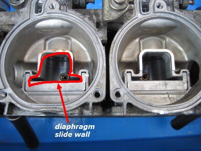

then the carburetor walls where it goes up and down.
