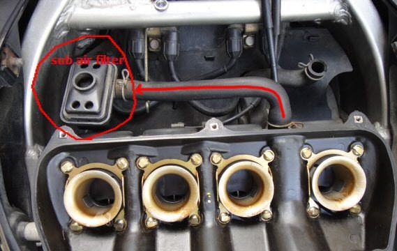

LIke on the ZZR1100 it connects to a rubber hose and goes into air box.

Originally Posted by Marty1999250RR
Any help please[/i]
it's connected to the sub air filter
where the lower side of the diaphragms are exposed to the atmospheric pressure

Hi a few things are happening with my bike I'm hoping to get some advice and help so the first thing is when idling in neutral If i pull back on the throttle very quickly nothing happens the revs don't go up it just sounds flat and the other thing is its misfiring at idle are these two problems connected? Could it be air fuel mixture? Where do I begin to explore

Also the sub air cleaner does that have to be there? Mine does not have it could that be the reason these things are happening?!
