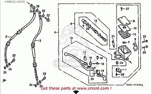

Please help are the two Banjo bolts bolts at the front exactly the same as each other?
Old Dec 16, 2017 | 12:40 AM
  #73
CaBaRet's Avatar
Joined: Oct 2016
Posts: 2,519
Likes: 8
From: Lancs ,UK
They should be Marty
Old Dec 16, 2017 | 01:28 AM
  #74
Marty1999250RR's Avatar
Joined: Nov 2017
Posts: 167

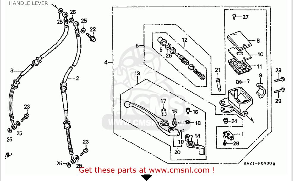

I’m getting so frustrated got two second hand calipers and I can’t seem to get the holes in the bolts to line up with the holes in the brake line so the fluid can flow through
Old Dec 16, 2017 | 01:36 AM
  #75
CaBaRet's Avatar
Joined: Oct 2016
Posts: 2,519
Likes: 8
From: Lancs ,UK
Hi Marty you don't have to worry about the holes, whats more important is the 2 copper washers (number 25 on the diagram )that sit either side of the metal connection, the bolt is just a conduit to send the fluid into the caliper, this bolt should be really tight to stop leaks
