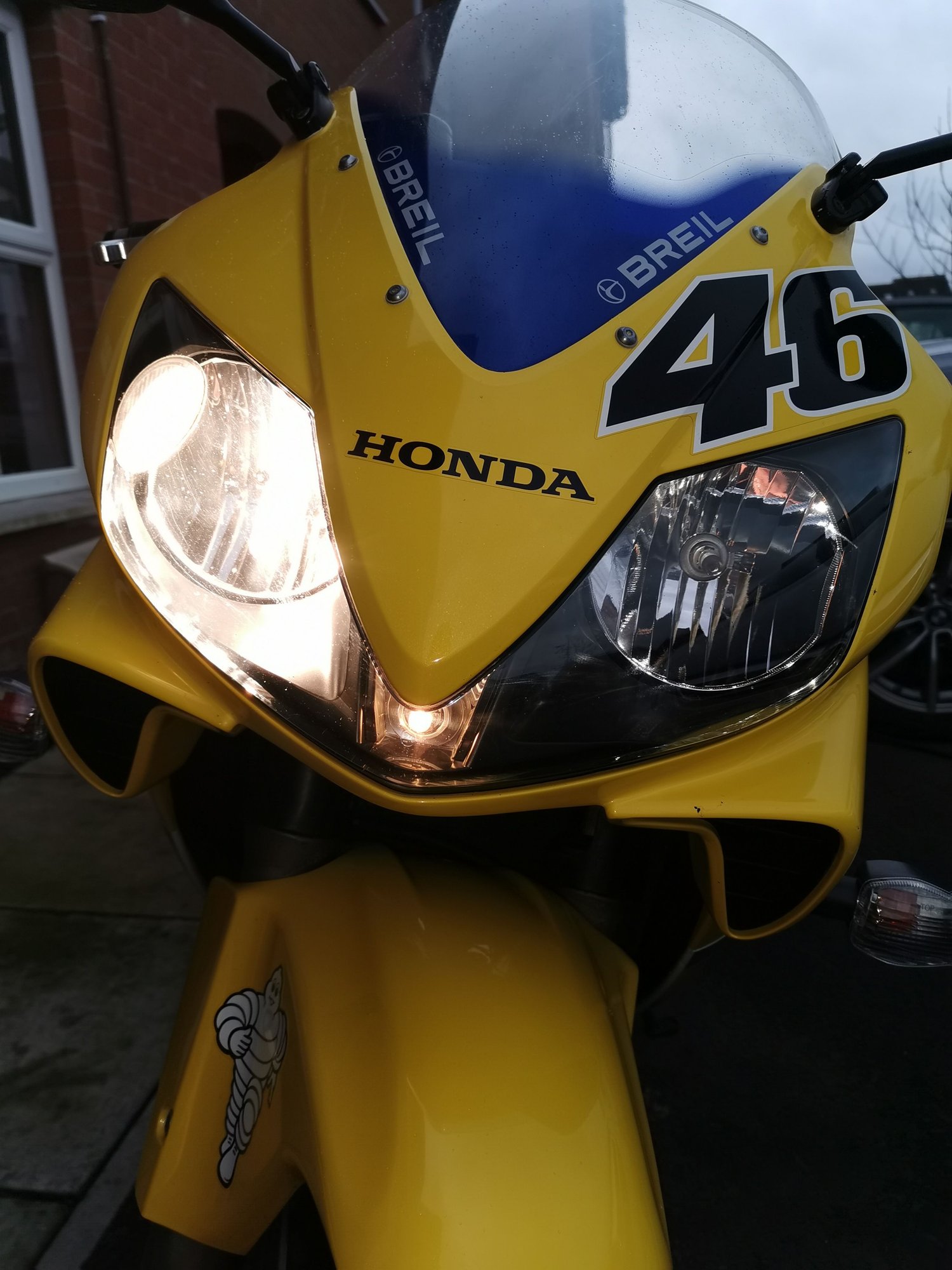

Also with the headlights can someone advise if I have a bulb out or should only one side be lit when I have the normal beams on. Do both only come on when full beams are on? Both work when I turn the full beams on.
See the attached pics.

The headlights are a-okay. Only one lights up when you aren't in "bright" mode. I had someone point that out to me when I first started riding and thought the same thing, i.e. something was wrong.
