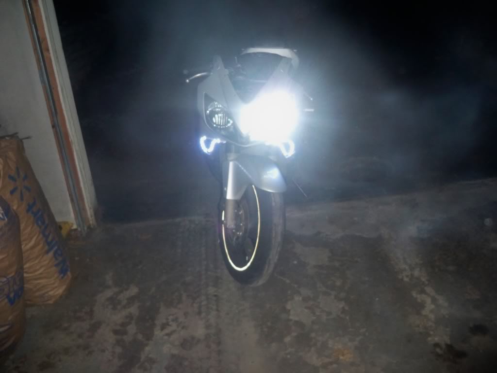

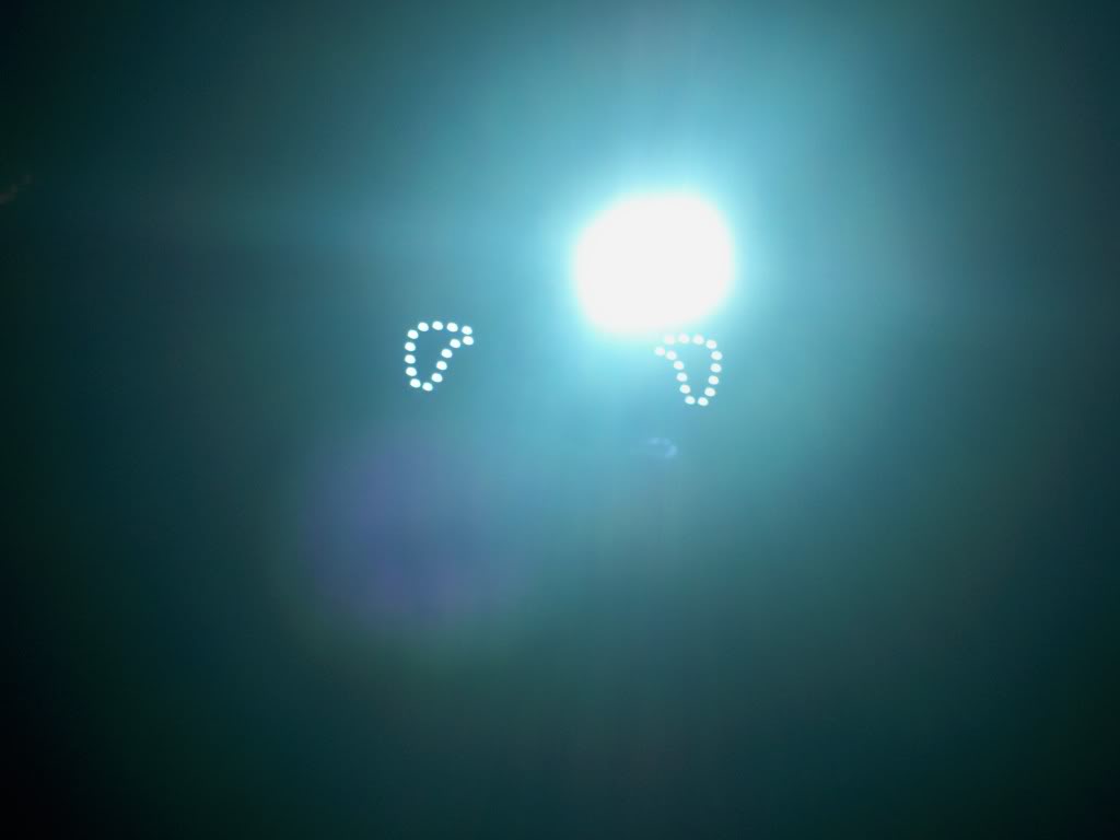

Originally Posted by vkurko
ok im a little confussed do you think you can help me... i just got smoked front blinkers... they only have a yellow and black wire... i understand what the stock wires are and what the colors are... and i know how to make them just blink when the blinker is on... but i want them to stay on as well... i followed you all the way up to the diodes.... can u explain that a little more to me and do i need to get them? im sorry i am a girl and i have done wiring before but not like this... thank you so much...
The Diodes are 1N4001 and as explained you can get them from Radio Shack or a store like that.
Thanks for the write up, I installed LED Strips in my intakes and made them running lights and left my flush mounts normal so when the blinker is on the alternate back and forth.
