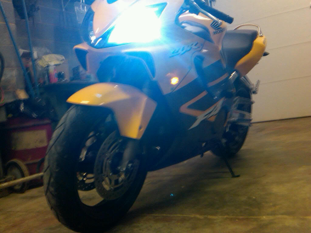

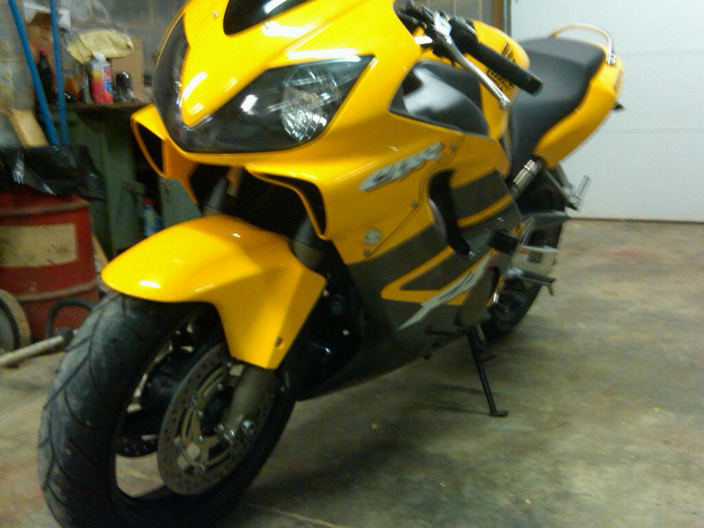

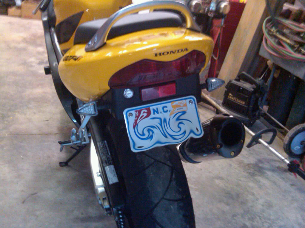

Its been raining on and off here since Sunday so i figured id work on the bike. Just got done installing my flush mount and short stalk signals. I was able to wire the front signals to stay on as running lights with Redz' instructions. I also got the flashing rate to stay the same with the resistors he recommended. Thanks for the help man!
Sry for the crappy pictures...I took them with my BB.
