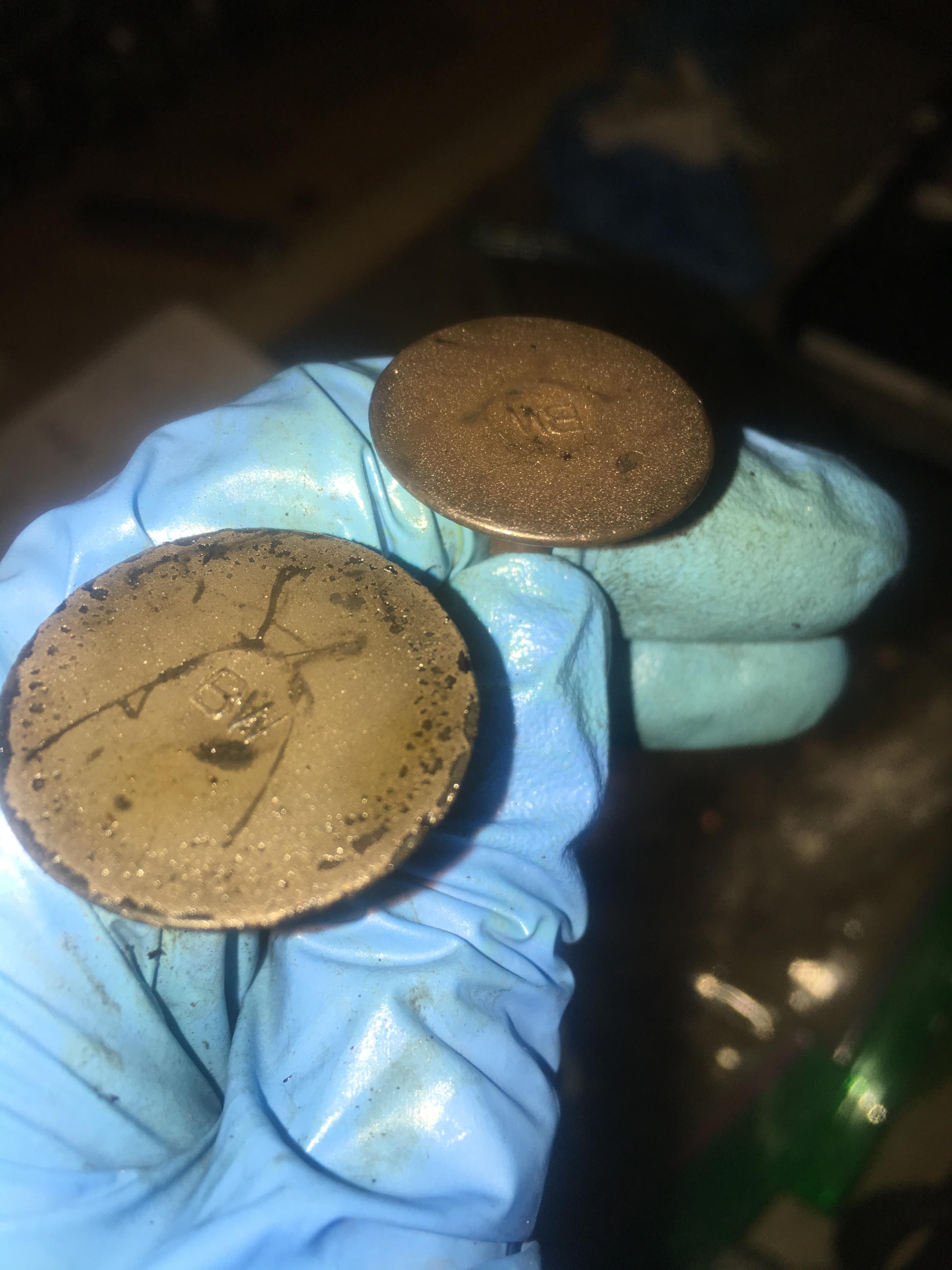

I also measured valve clearances on the new engine. All intakes .17-.18 (still barely within spec) and exh .21-22 (all too tight) which seemed fairly standard. HOWEVER when I took off the camshaft covers I discovered something interesting...
Can you see it?

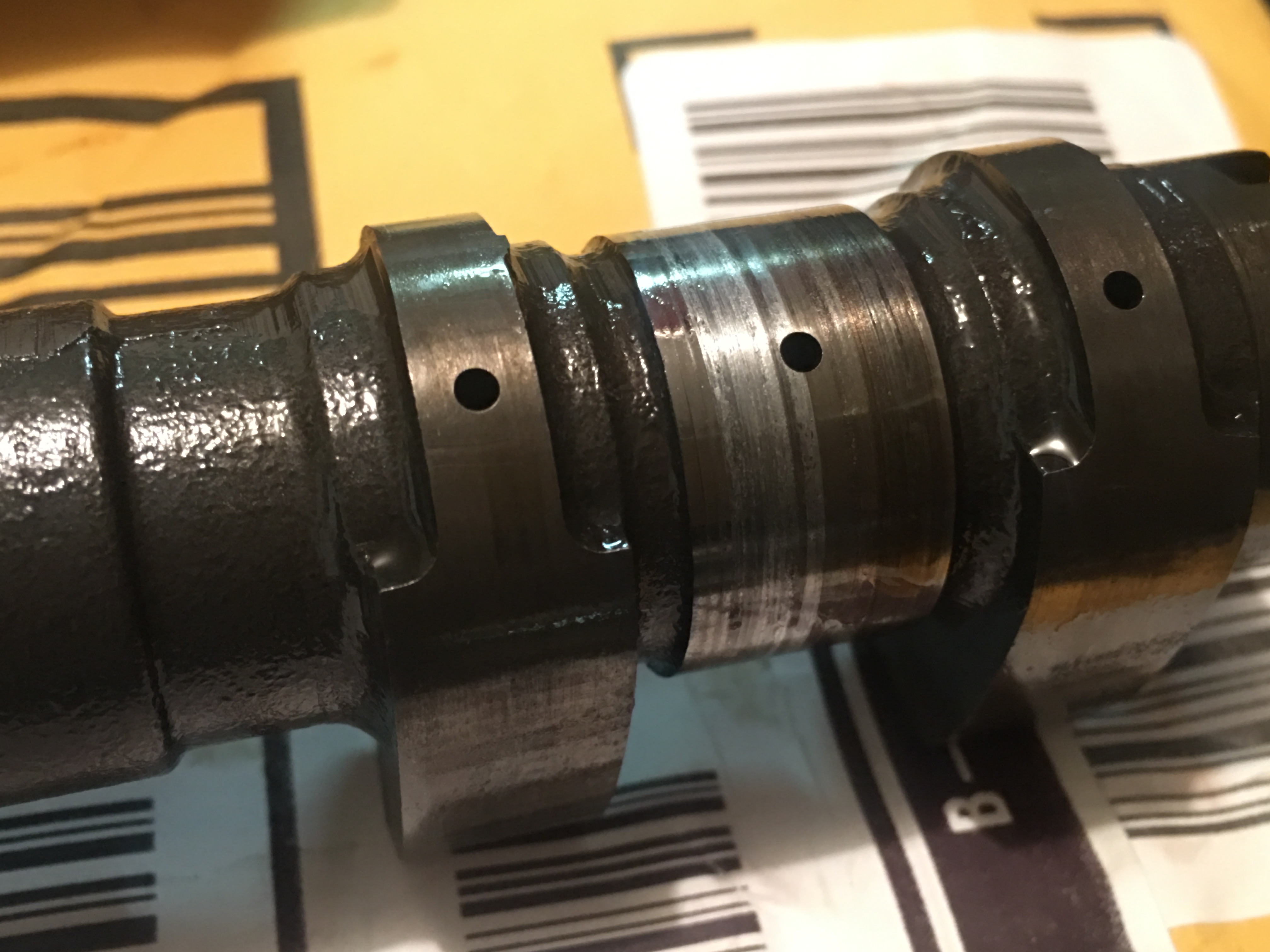

Corresponding surface on camshaft
I guess it's pretty clear which cyl head I'm going to use for the rebuild now

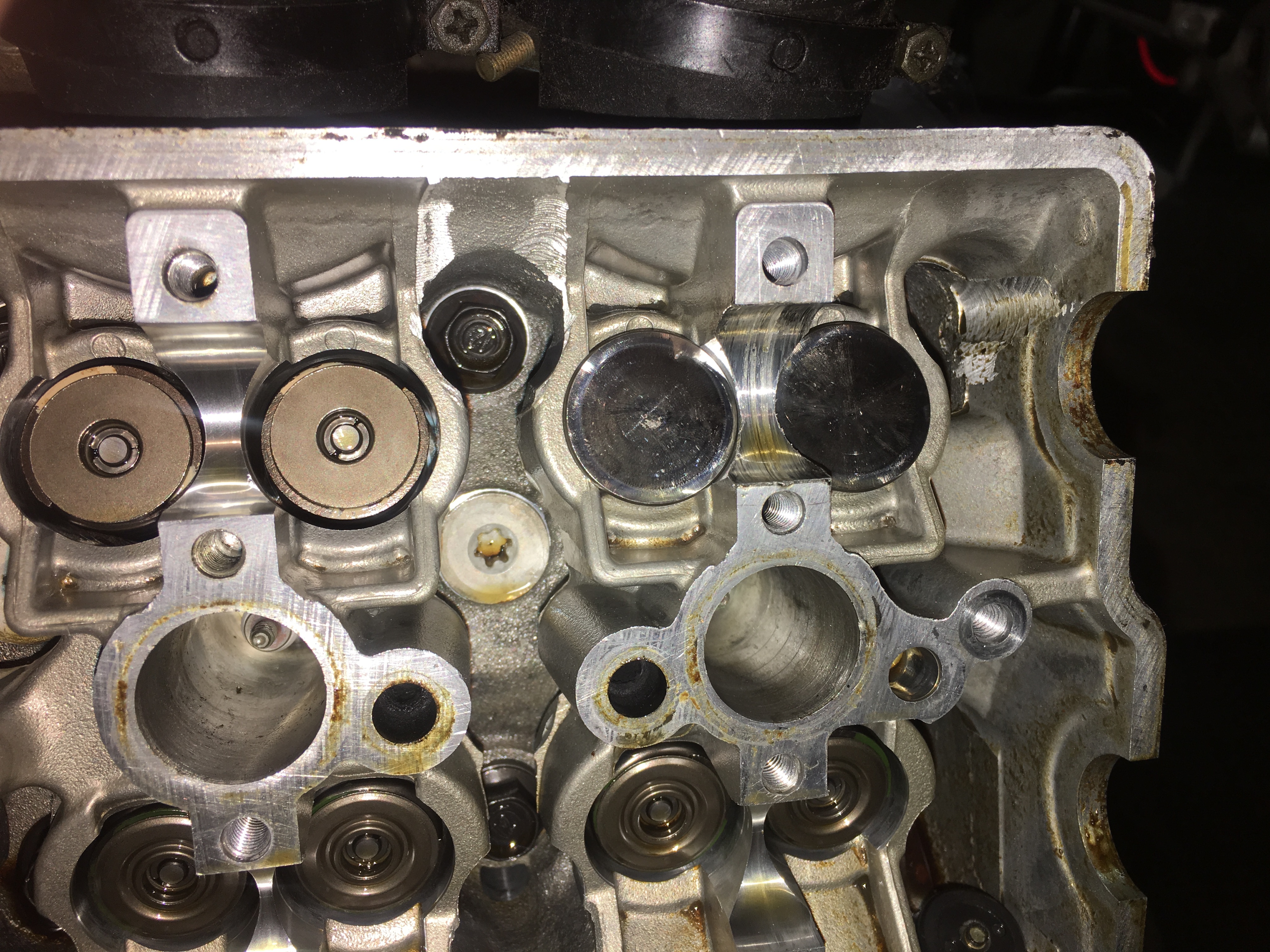

Think I need new valves as well, the exhaust valves dont look too bad but the intakes look kinda bad to me dunno if they're worth trying to fix up. These are from my old engine, dunno about the new ones yet until I take them out

like said exh held integrity.. sadly not carbon on intake.. toast.. other head and cams not tore up? good as this wont hold oil.. cyl 2 less wear most likely toast rings so was oiled all the time. Not good for a small area of explosions, but.

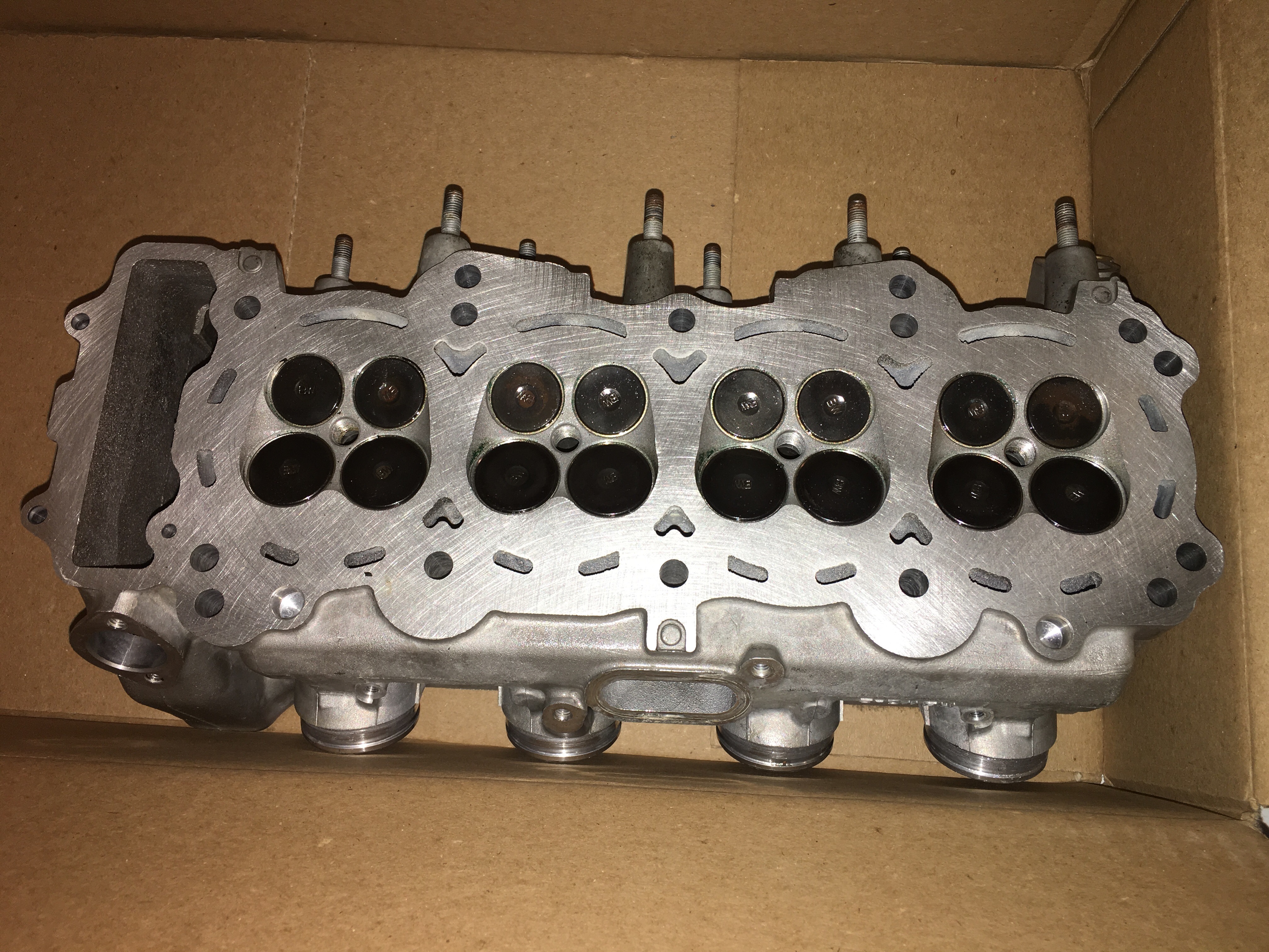

However I finally got the valves done at a local place like everyone suggested, the guy found a set of valves he could reuse from the 32 I brought him so no new valves bought just like you said, just new stem seals
There's some green stuff around the valves, I'm guessing it's the stuff he used to test the valve faces.
I tested it by putting acetone brake cleaner on the wells and blowing compressed air through the intake/exhaust ports. No bubbles
But I wanted to test it more as well as test the cylinders of the junk engine before taking it apart, I measured the tops of the cyls inside diameter and they were good so I put the rebuild head with a new headgasket on the junk engine. I read online that as long as engine hasn't been fired it's ok to reuse headgasket, and at the very worst I'll just buy a new headgasket. But I thought it'd be great if the junk engine ran that way I can still ride while working on rebuilding the original
So I did several leakdown test without cams on the rebuilt head + junk engine, and got some really weird results
