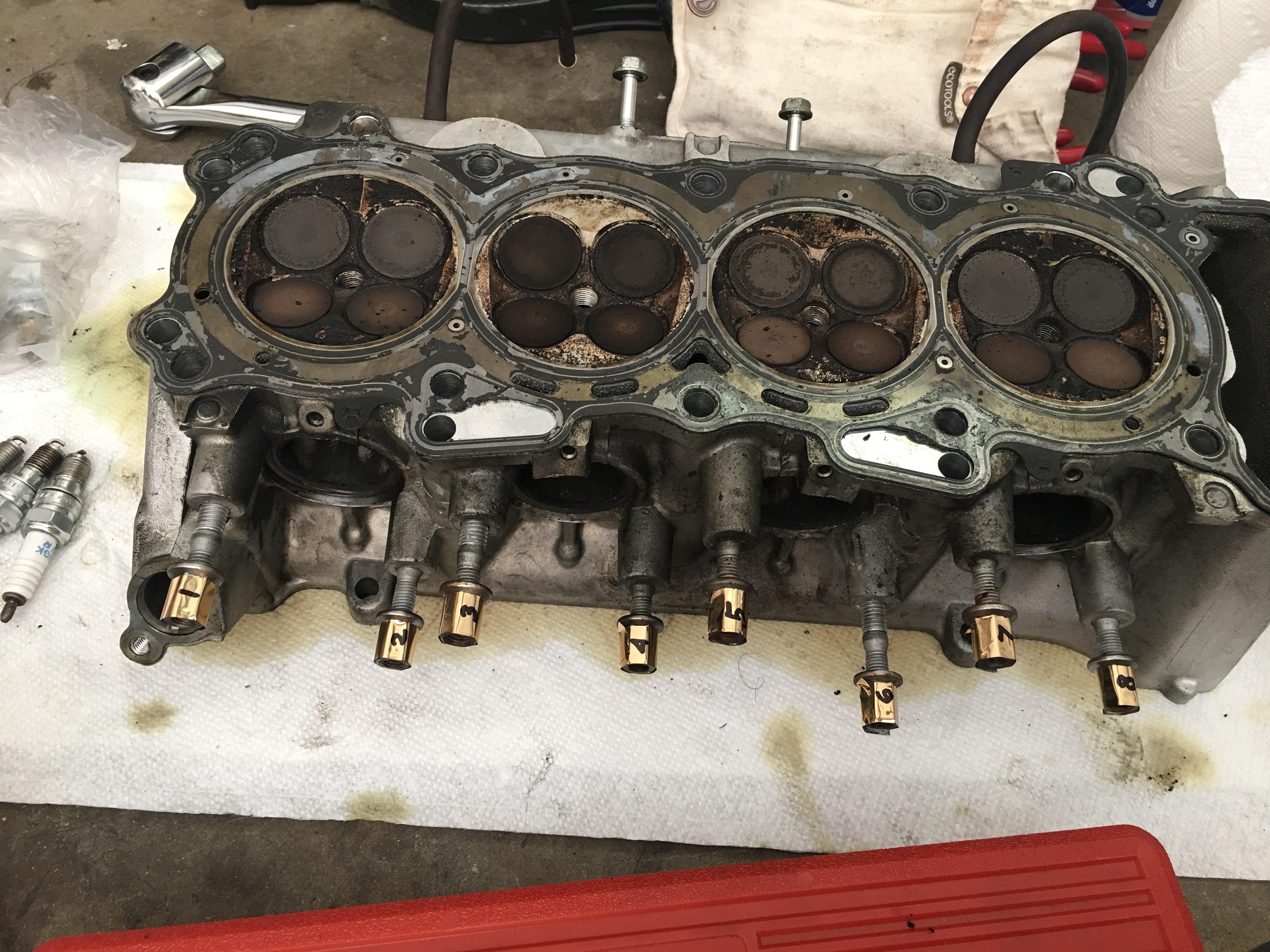

Bought new engine: how workable is this
Sorry another thing... these are the burnt valves from my original engine, is any of it salvageable? could I get away with cleaning them and lapping
or full rebuild w/ seats cut and new valves new everything
Not sure about the other engine yet, but don't have much hope from you guys' assessment of the rust

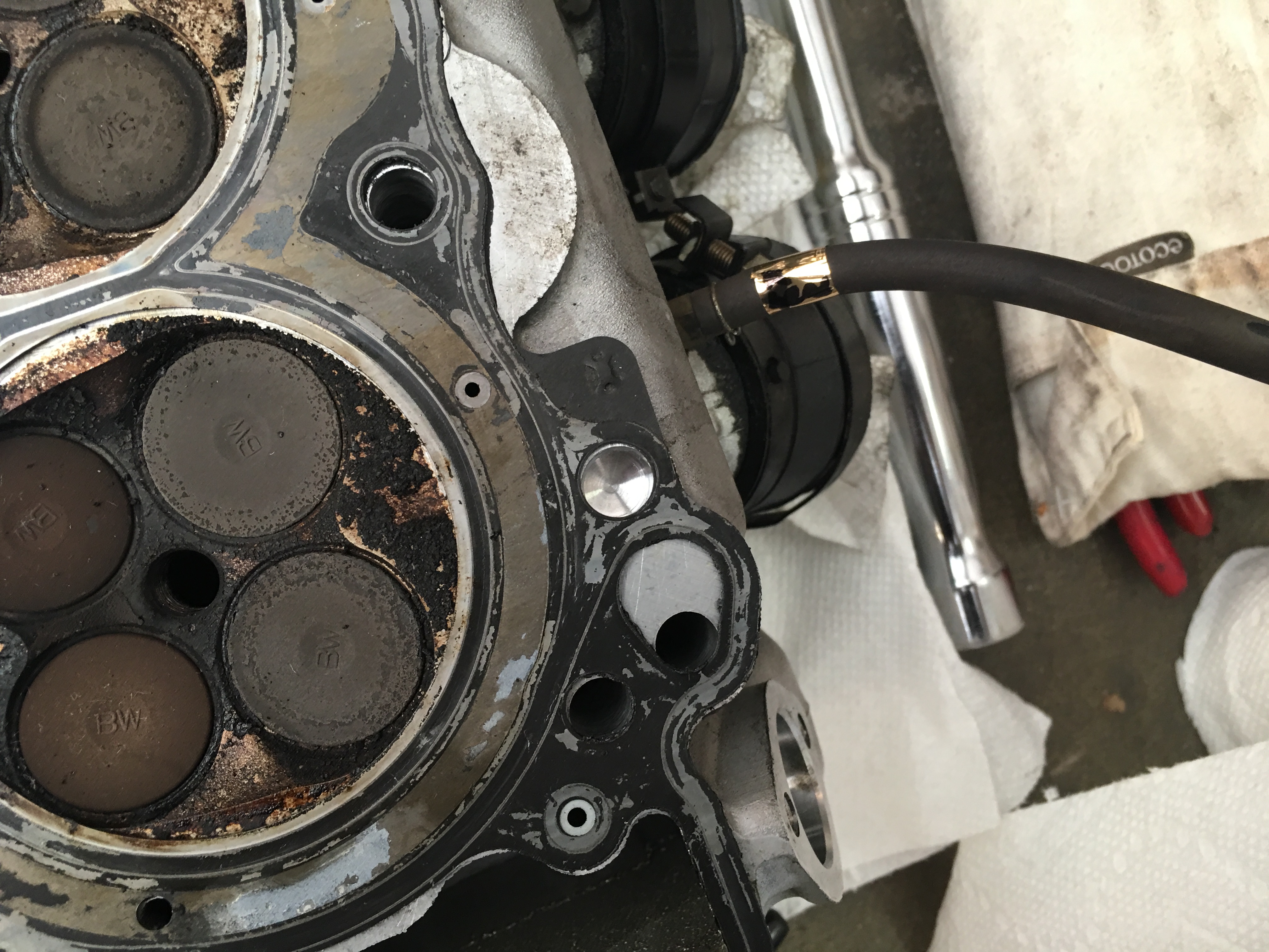

exhaust valves look good for clean and go, the intakes are abit haggard but may just be buildup. On cyl1 intakes look like they've lost their edge maybe(cant tell if its pitted or carbon flecks), but you have 8 spares if they don't also clean up.
See how the exh valves all maintained their edges smooth and round that's good. They'll shine right up.
Ive seen much worse that looked great after a dip and scrub.
Pull the valves and poke them in a piece of cardboard in order, remove clean replace 1 at a time. Dip the stripped head a day then scrub then dip then scrub till it looks new.
Then measure valves(mark on cardboard) and seats, might have to switch them for best fit.
only if seats are really niked up do you need to cut and then very lightly.. very. Be sure to use the type with the rod that goes down the guide, not the freehand one, to guarantee angle of cut is square. tight fit in the guide, there are several sized rods use the largest that fits. But I expect wont need to cut any seats on a 17kM motor.

Those compression #'s are over 100psi off. You should have done a leak down test and figure out where it's coming from on your engine. Absolutely you can just hook up your battery to the starter. You don't even need the headers or intake on to read compression. There are a lot of YouTube videos that show you how to diagnose where your leak down is coming from. But mainly, you just want to make sure your bottom end is holding the compression. Do the compression check on the new engine. If the numbers are low, add a few drops of oil to the cylinder. If that boosts the compression - your rings are worn. If the numbers stay the same, the leak is in your top end. Obviously, if it comes back in the "minimal leak " zone, you should be fine.
The bore doesn't look bad on the jugs you posted. That doesn't mean much though from just a picture...
Demon is 100% correct on taking the head to a machine shop. Being in SoCal, you should have a few local options that are reasonable. They assemble the head and make sure your valves are properly seated, they make sure the head isn't warped or cracked. It makes too much sense not to do it that way. If you have 1 good%

I did a leakdown on the new motor, Will do compression test soon
in 1 - leak
ex 1 - leak
cyl 1 - a little leak
in 2 - very little leak
ex 2 - leak a lot
cyl 2 - could barely hear anything; less than cyl 1
in 4 - medium leak
ex 4 - leak a lot
cyl 4 - leaks somewhat ..? (more than cyl 1)
in 3 - yes (tiny bit)
ex 3 - yes (tiny bit)
cyl 3 - yes (very little)
No other leaks so it seems the blocks themselves are ok
The exhaust valves leaked so much the motor wouldn't hold air long enough for me to get a % reading. Cyl 3 was the only one that would hold enough air, I got about 11~12% loss (70/62psi) couldn't get it to hold more air than that
I'm thinking maybe the valve clearances are off that's why it wouldn't hold air, either that or the valves/seats being way gunked up?
I'm hoping that at least cylinders (from old or new engine, whichever is better) can be reused with ballhoning and a re ring, etc. I dunno what I'm gonna do about the head, hopefully I can find somewhere that does it for less than $2200 but if I can't I 'll really have to think about it, that's like the rest of the bike's worth lmao. I've been thinking so much the last few days/nights thought about selling/parting everything out, to rebuilding myself talking myself up, to just throw my savings at the shop and have them do everything, to setting it on fire and forget about it hahaha. It was such a perfect day for a ride today.
