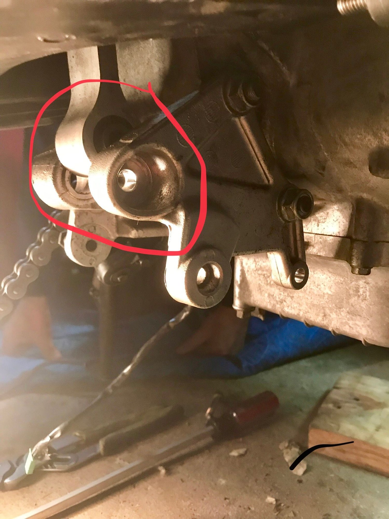

sorry to hijack, i am finishing an engine swap and i wanted to know if i can use this wrench to decompress the spring would help me link this suspension link up with the rear engine hanger,
