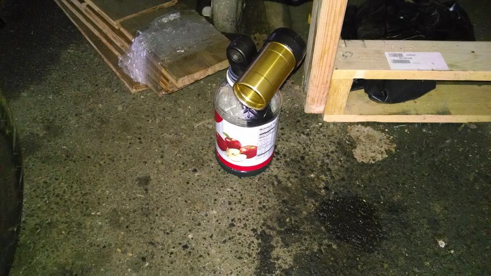

Quick question input new bearings in the rear wheel and ordered two of the same size bearings. Seems that was the wrong move because one side is smaller than the other. Are the seals the same story?
I remover the charge out of the rear shock got the circlips out and am currently searching for a but that will thread over Schrader valve to protect the threads. Any ideas on pitch ? I've come up with nuthing .
New update as well I bought levers for the girl on fleaBay for 20 bucks. The brake side fit in like a glove but the clutch perch was destroy, i got frustrated. Any ideas as to why this side was so tight. The perch came off my parts bike which had been beaten to death two or three times.bbutbi didn't see any obvious damage just a mismatched bolt as a keeper.

Here's some pics of progress looks about the same lol.
For those who are more skilled in the suspension department, how can you test the shock bladder for leaks? It just comes apart outside of the tube, making it difficult to do a submersion tested. All well I replaced the Schrader valve and will order the seals tonight.
