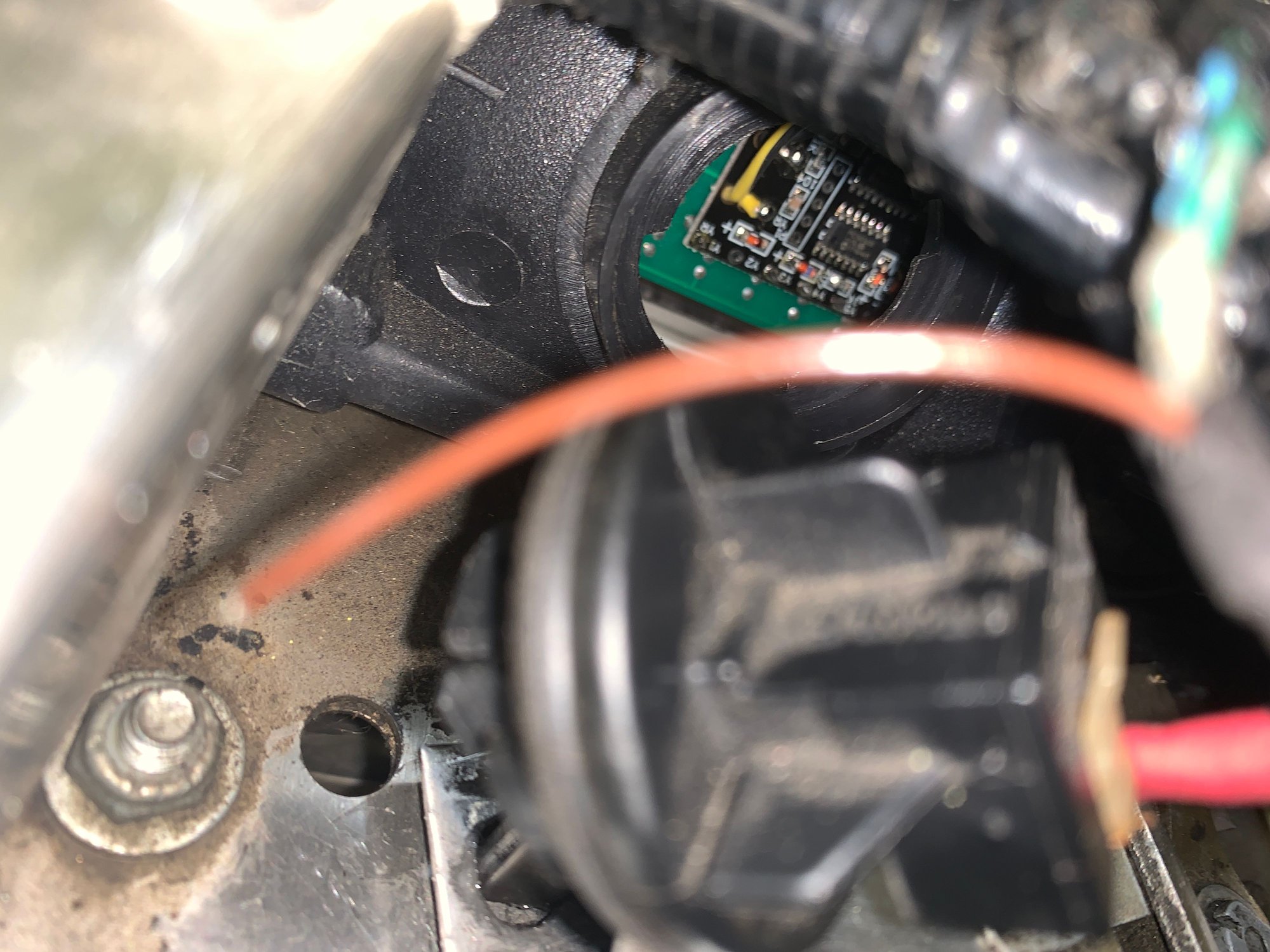

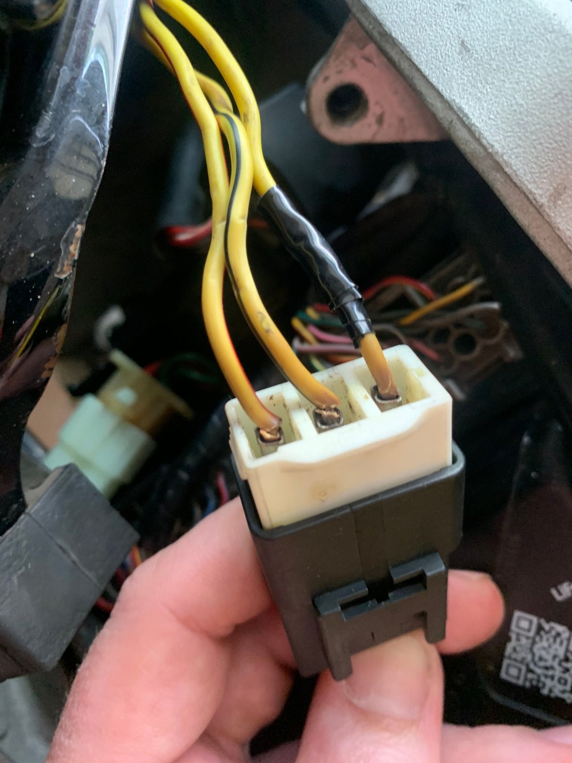

CBR 929 wire keeps melting then blows fuse
That's power wire from starter-solenoid to fuse box. Problem ISN'T any part, it's WIRING. So put every original part you replaced back on bike.
Unless it's brand-new sfactory OEM part bought from authorised dealer, then leave it on. Also remove any and all non-factory wiring and non-OEM electronic part. Like LED winkers and integrated taillights. Installing those things always causes damage that blows fuses endlessly.
Once every non-OEM part has been replaced with original OEM part, then we'll measure each and every single piece of wire in harness to find short.
and only thing I could put back on is the kill switch and the other rectifier and I put in a new starter solenoid didn’t help anything but ok I disconnected the computer and the kill switch was on and tuned key on with new fuse didn’t blow plugged the computer back in didn’t blow then I dipoles the kill switch to off then back on and it blew the fuse and I send a pic of the crap job they did to the taillights but somehow they still worked before the battery blew but now I got a new stator and the old ones trashed but it had wires burnt up and sticking out of it so surprised it worked these next pics are from the old stator wires
and more and more I get into the bike **** bolts missin like the only three bolts in the stator case should be four
and only thing I can put back are thos and the kill switch
and when I hit my back breaks the taillights do a triple flash idk wher the flasher part is unless it’s in all that wiring in the taillight area but it’s all just cut wires and u think i should cut the taillights to disconnect cuz dude I got it from didn’t use any clip-ins and there no bulbs in this taillights it’s a led computer looking board inside the tail
lights
