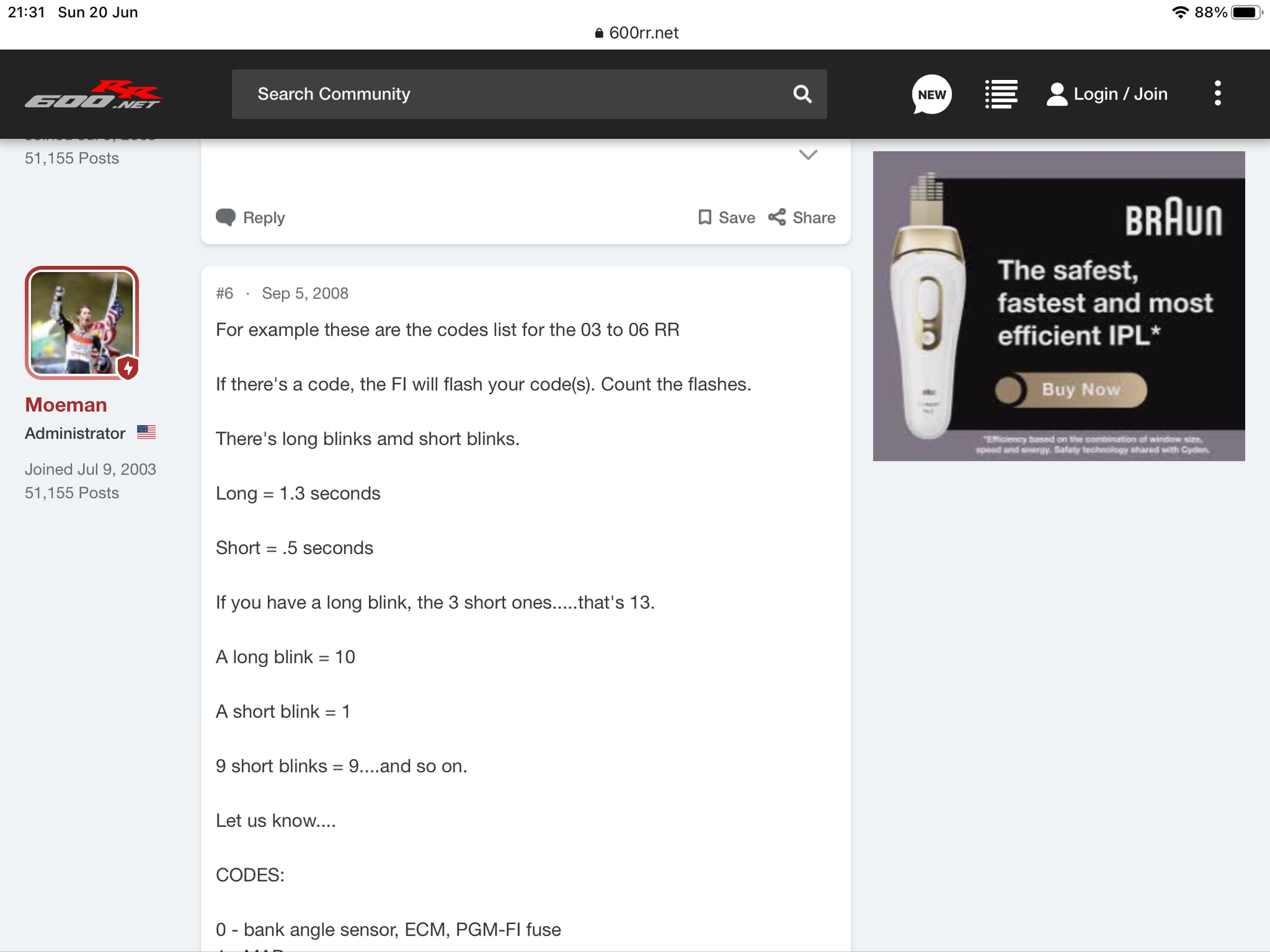

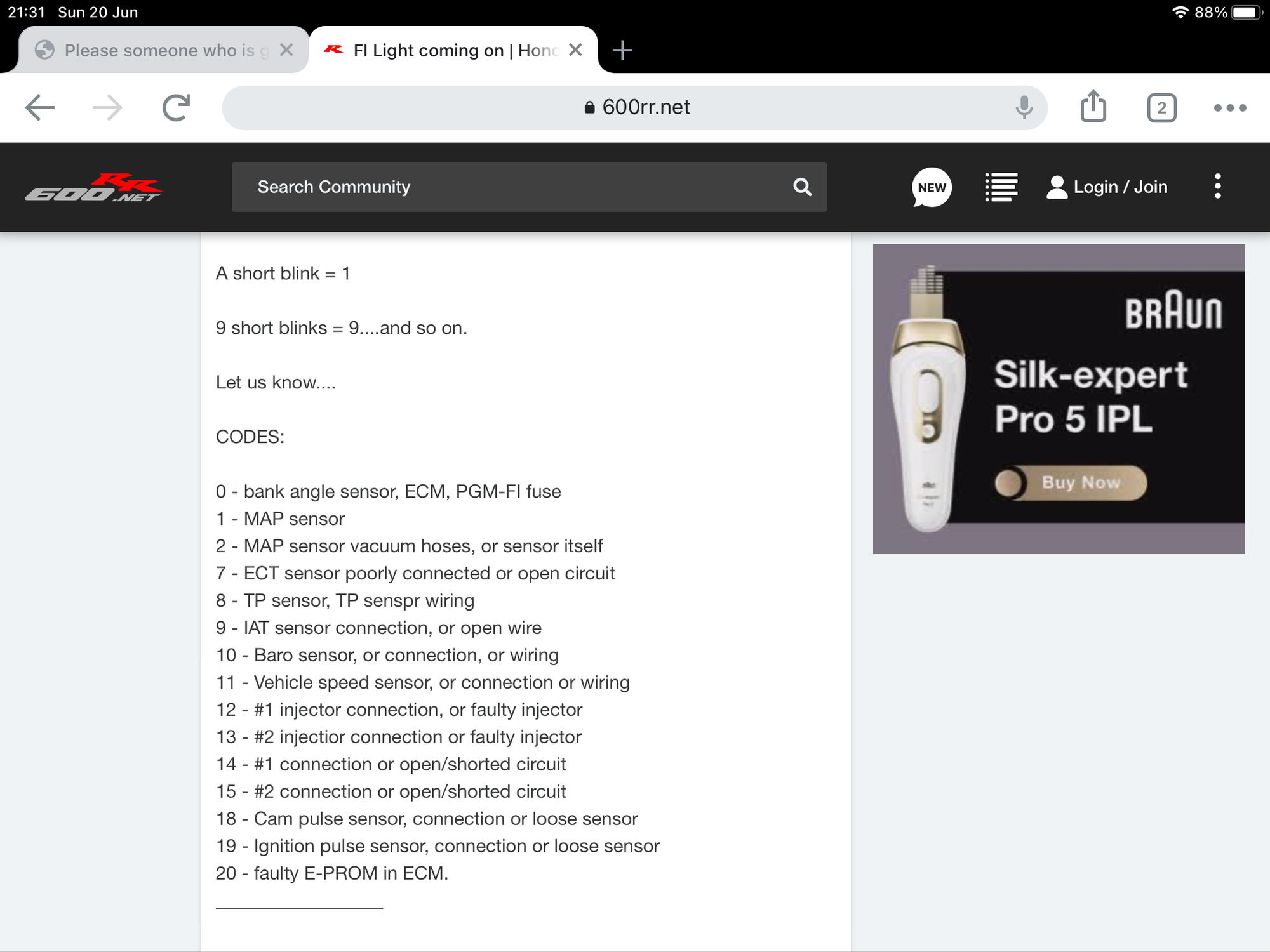

Hi fella,can you turn the ignition on with the kick stand down?does the f/I light blink?if it does these are fault codes here is a list of them,
Got these off another forum,hope it helps 👍
