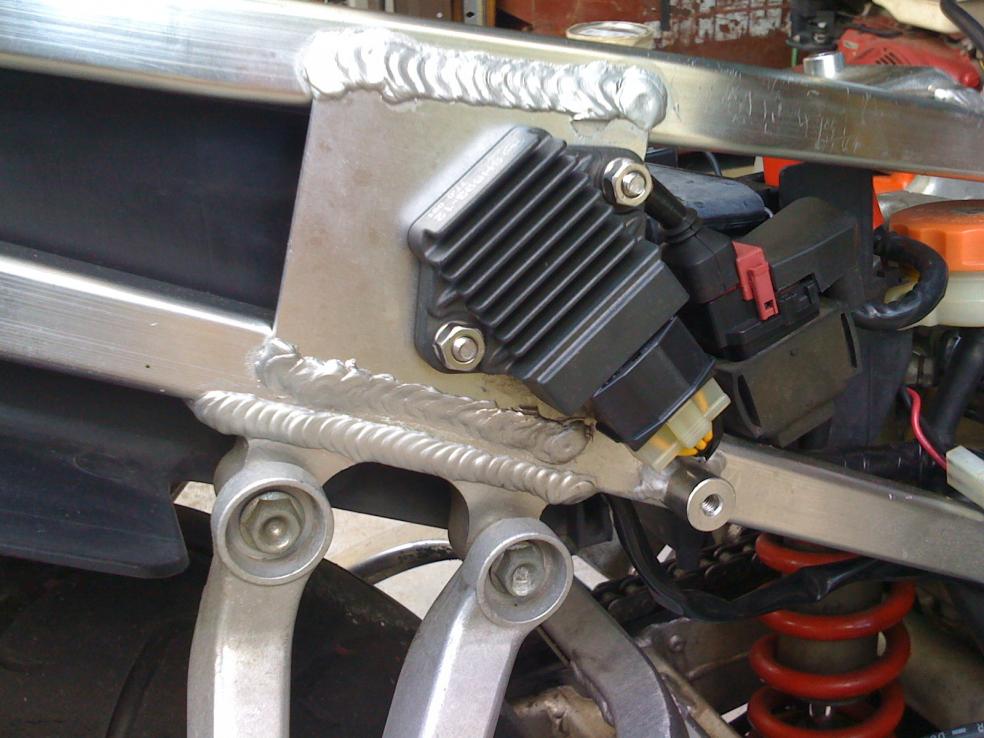

as youve already heard , the charging system is the weak point, i had to replace my stator(the epoxy the surrounds the copper was flacking off into the oil)and the wires were yellow and the connector was melted . replaced my rectifier with the newer style with cooling fins (see the pic) and a brand new battery, this fixed my problems and never had another issue with the electrical, my bike had 36k mi on the counter and it was time for those parts im told. i did all the work my self with no problems. the biggest hurdle you will find is trying to find aftermarket parts for the old girl. for instance i had to pleed with the guy at lockhart to make another run of speenscreens so i could get the smoke double bouble i wanted(no-one had anything to fit ), i had to fab a flange to make the jardine pipe i bought work, but let me say that my almost 20 year old bike will run with the pack and pull the front wheel for as long as you have the *****,peece bro
