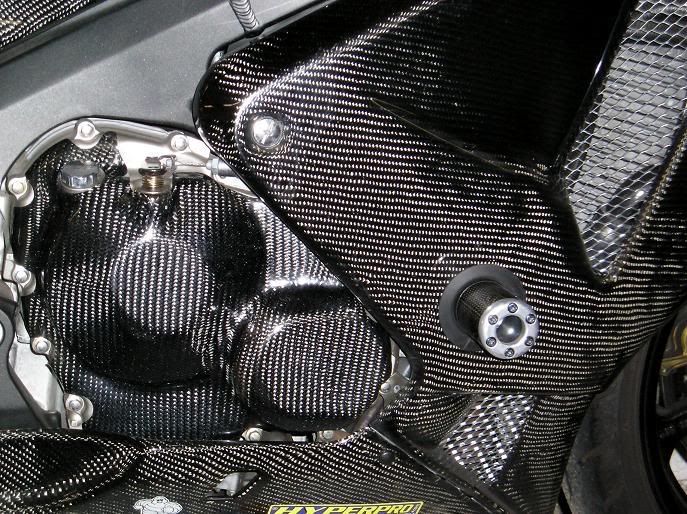

from what ive seen, no-cuts cause more damage than the fall did, 2 different times ive seen no-cuts either bend or break and when they do,they bend into the case cover(actualy punctured the case one time)and the fairing still got rash,so now youve got a rashed bike bleeding oil all over.buy the cut sliders and do the laser install, simple and perfect cut youll be glad you did, and vortexsliders seem to hold up best our stunt bike has em and needless to say its been down a couple times! haha believe me it took me a month to talk myself intodrilling into my fairingName:  enginecasecovers.jpg
