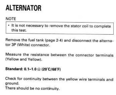

I follow this for testing the stator :
The strange thing is that I have 3 yellow wire coming from it, but they have continuity between all of them, so I guess my stator is bad then ?
Old Jul 17, 2020 | 08:23 AM
Posts: 7,177
It sounds like it could definitely be questionable.
