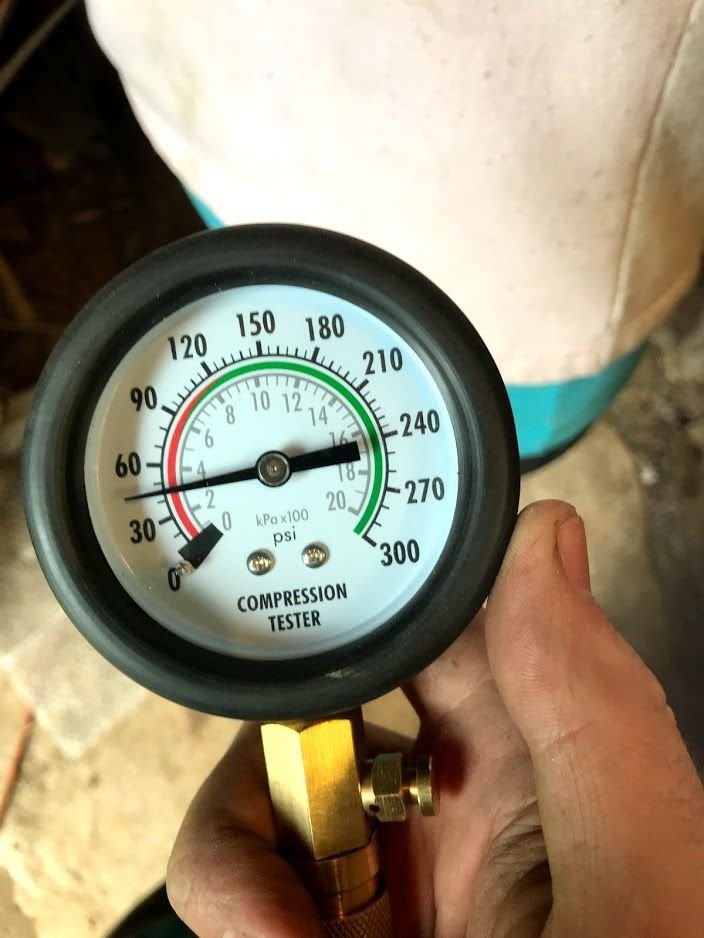

Long story short, I did a compression test, here is the result :
Stay calm! Equip yourself of the service manual, pretty easy to find and search how to check "Valve Clearance".
My exhaust valve was all in spec, but my intake valve was all at.. ZERO!
Yep! Zero clearance, suprising that the engine was still running fine, so when the valve was supposed to be "closed" the camshaft was still touching the valve. Then keeping the valve open = lost all compression. Basically shooting it back in the carburator.
