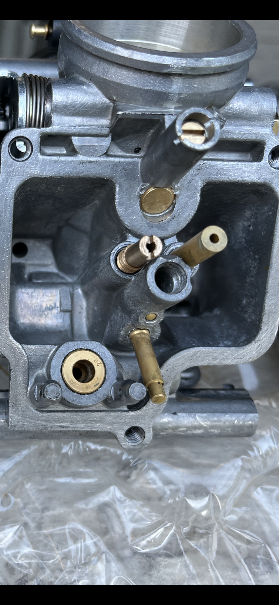

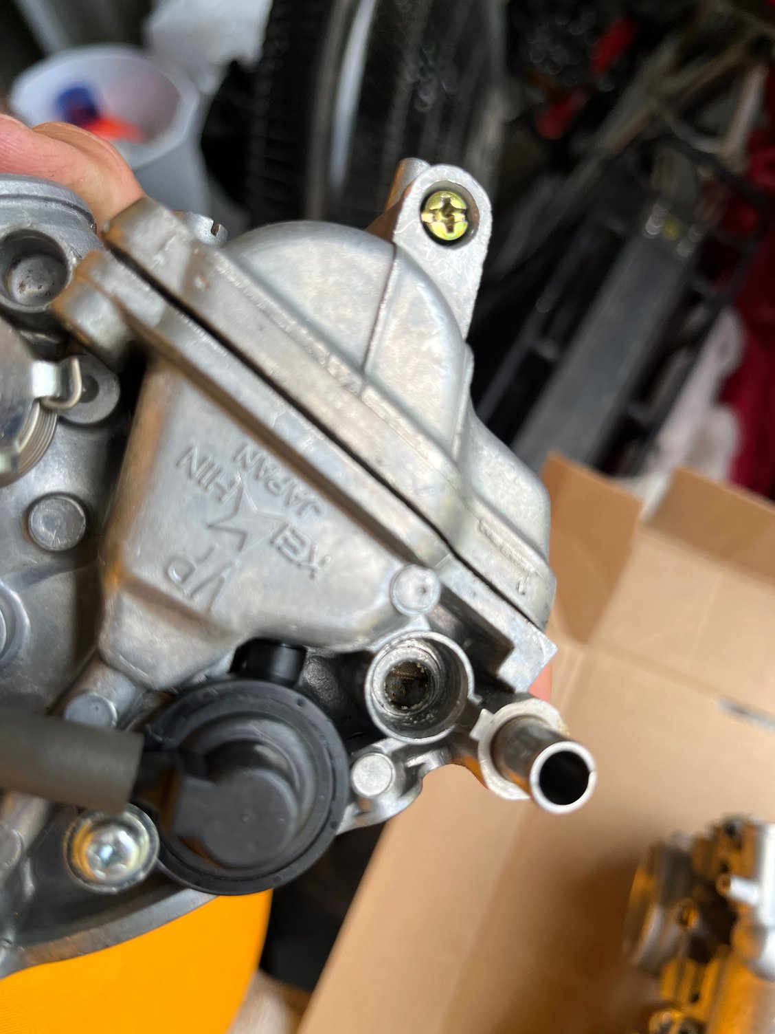

Any first impressions? What would you do in my shoes here?
I’ve used Chem-Dip however I didn’t use an any type of brush in the fuel rail of the carburetor until afterwards I noticed while assembling. (I do have an extra set of carburetors I purchased from a local person who’s home caught fire and their F3 was in the yard. Fairings ruined, handlebars, and seat, however everything else intact.). The float bowls and inside of the other carburetor has no corrosion.
Previous owner used RTV gasket maker as the o-rings for the fuel line-t and for the float bowl gasket. Was very messy and required removal of all the fine particles of the liquid gasket dried up inside the float bowl, and fuel rail chambers.
