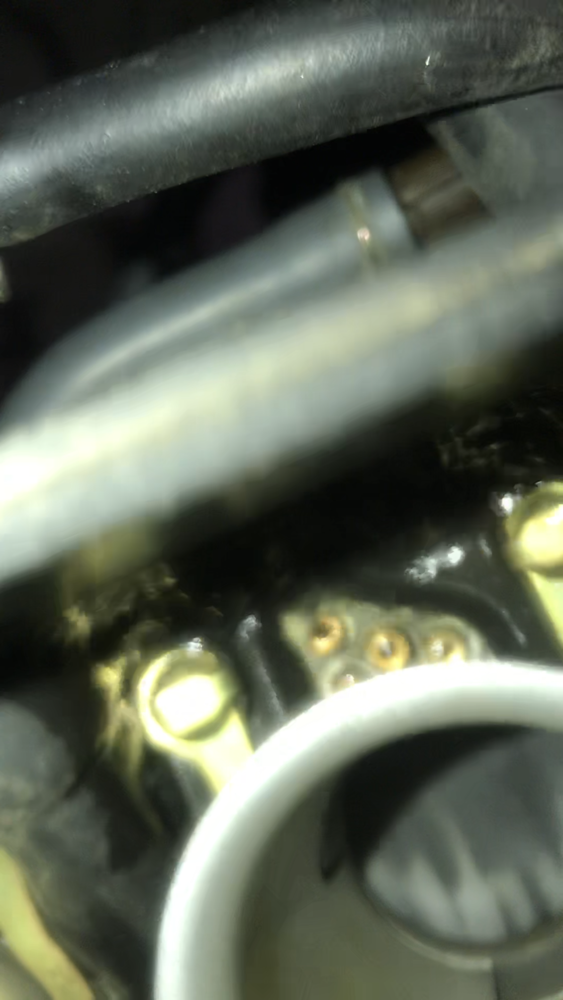

Exclamation
Any idea why gas is coming out of these brass tubes while the engine is running? already cleaned float and bowls. note also starts to bogg
Old Jul 18, 2019 | 06:07 AM
  #57
HAndHEldJEsuS's Avatar
Joined: Aug 2017
Posts: 44
From: Louisville, Ky
Default Lovely carb tuning
Yea your float valves are stuck open and it’s causing gas to flood and spill out the air inlets. Try Tapping LIGHTLY with hammer might unfreeze them. If not gonna have to pull carbs and the float bowl to see if it’s locked up or jus need to be cleaned a little more
