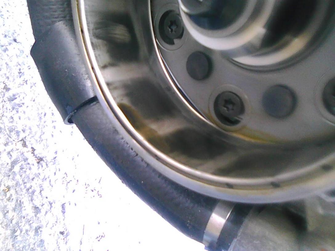

i have gone through 2 regulators now and i think my stator is bad now is the inside of the stator housing suposed to look like this? any help plz

Hmm, when I had my stator cover off I don't remember seeing the staggered pattern like that, but I can't imagine the housing can fail since its just a metal dish of sorts. Have you tested the stator?
Another thing to look into is doing the GSXR regulator conversion. Do a search under the F3 section under GSXR regulator and you'll get a bunch of threads that explain what people have done in the past. Seems the F3 regulator is a weak point on our bike, granted they are over 10 years old something has to give.

The stator is an electromagnet. It has coiled iiron plates that spin around the center, and react with magnetic plates in the housing. That staggered pattern shows where the plates are. For something to be attracted to them like that, it'd have to be made of iron. Could just be iron dust form normal wear and tear of the assembly.
