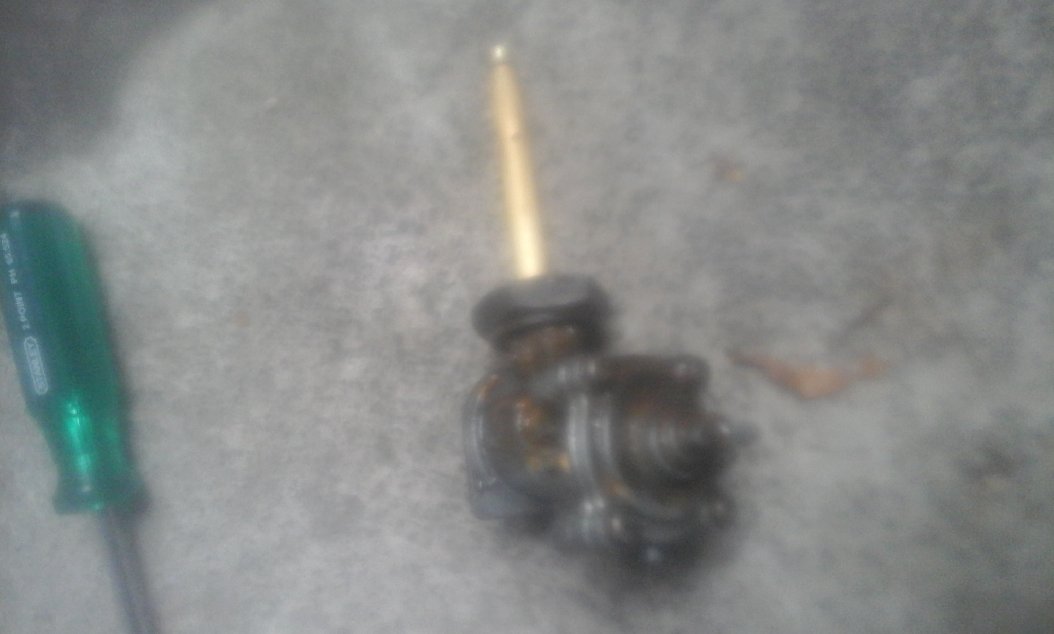

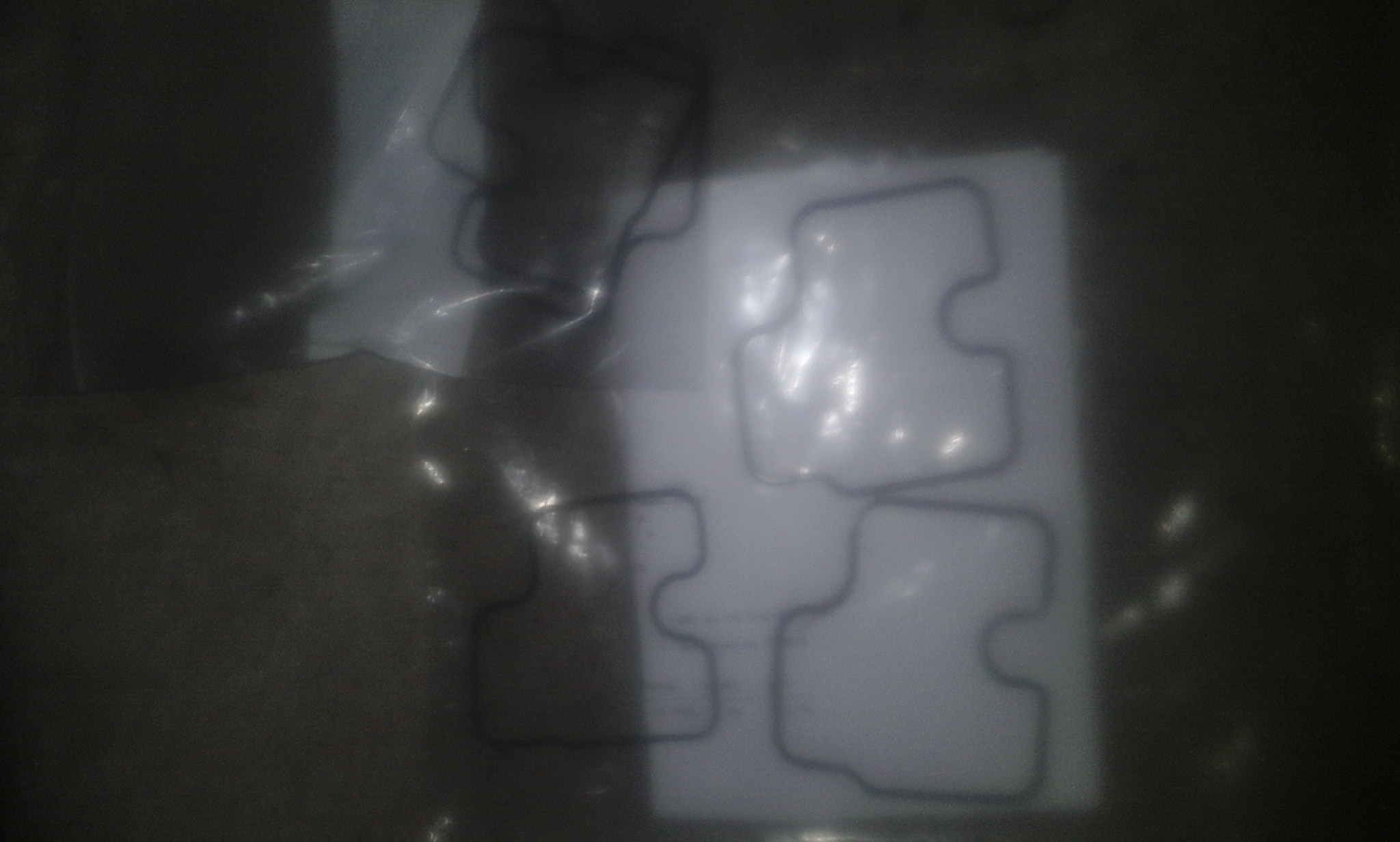

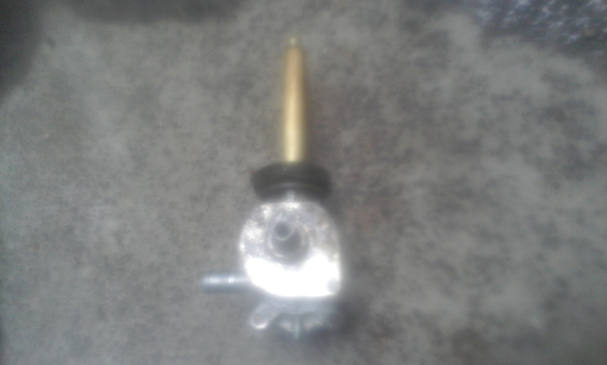

Today I fixed the fuel leaks. The tap was stuffed it would leak 2 litres a day when off! I got new carb bowl seals as they were dripping slightly. Surprised to find inside the carbs all nice and clean! Do need a sync though it is out by a margin. Well the new seals didn't fit. So RTV on the old ones for a quick fix until I can get proper replacements. Holding for now. Tomorrow I'm doing the rear caliper. I know I said thermostat and coolant flush but I don't have the time this weekend. It's happening soon. Desperately need an air filter its way due for replacement, plugs and fuel filter too
