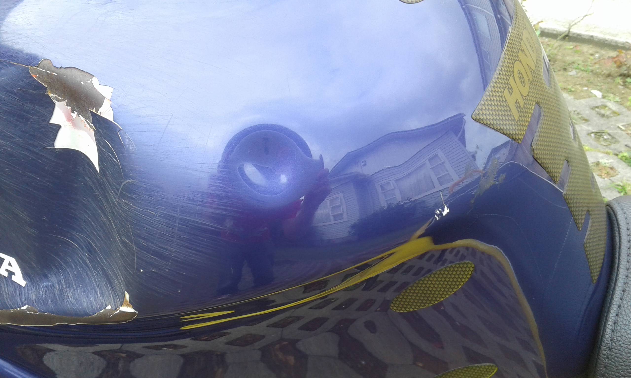

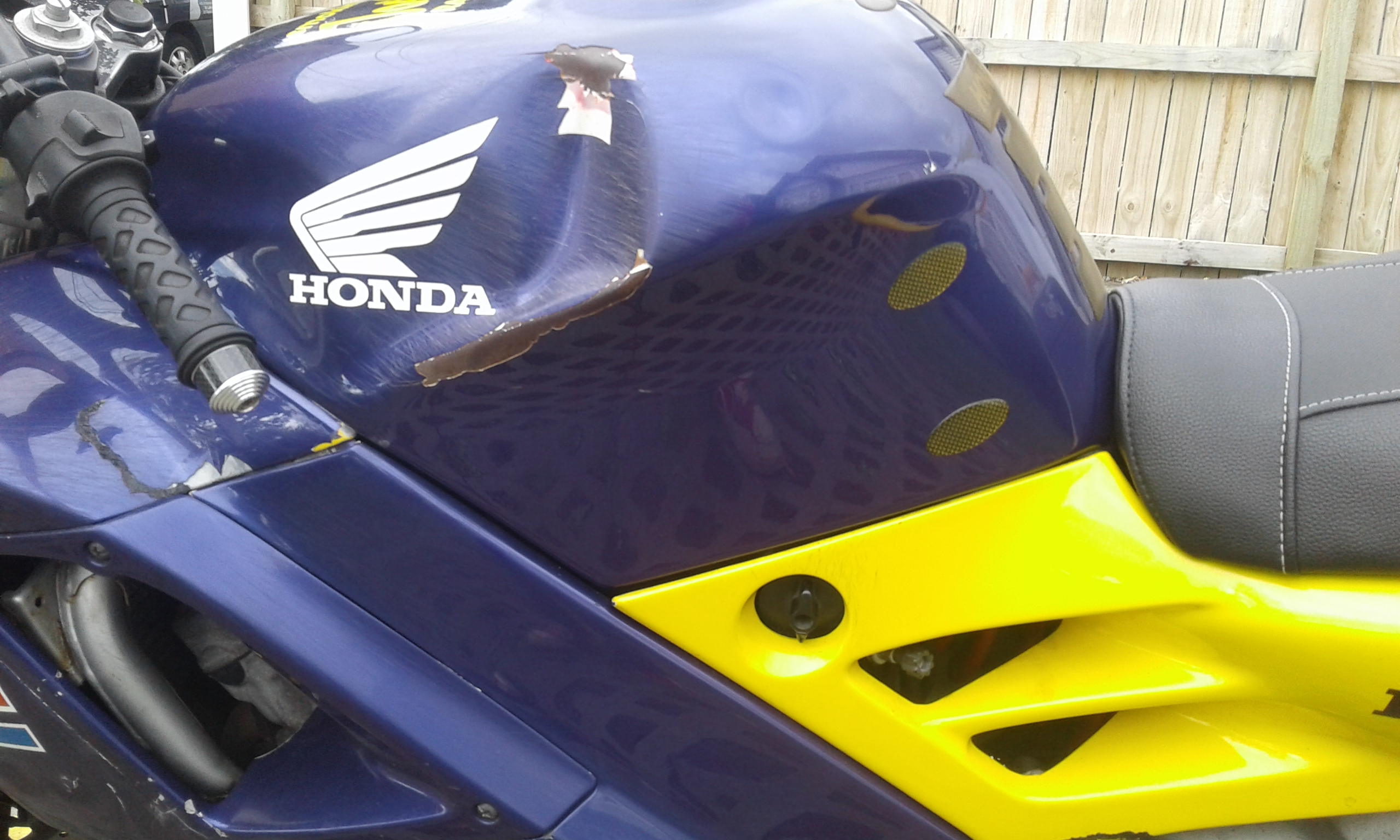

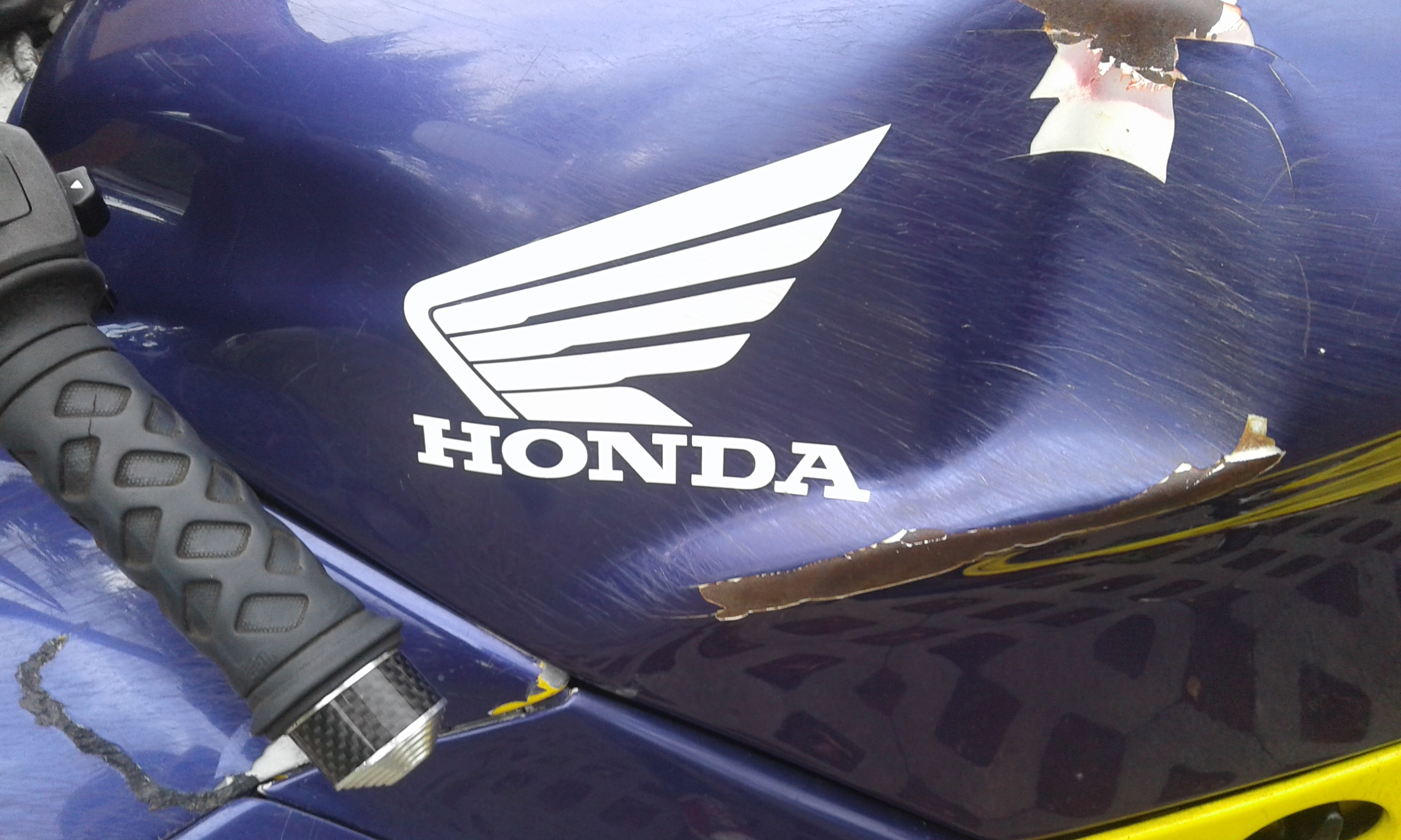

Tank
Attached Thumbnails The resurrection of Smokin' Joe-20180227_164753.jpg   The resurrection of Smokin' Joe-20180227_164747.jpg   The resurrection of Smokin' Joe-20180227_164744.jpg   The resurrection of Smokin' Joe-20180227_164802.jpg

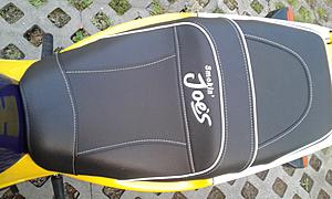

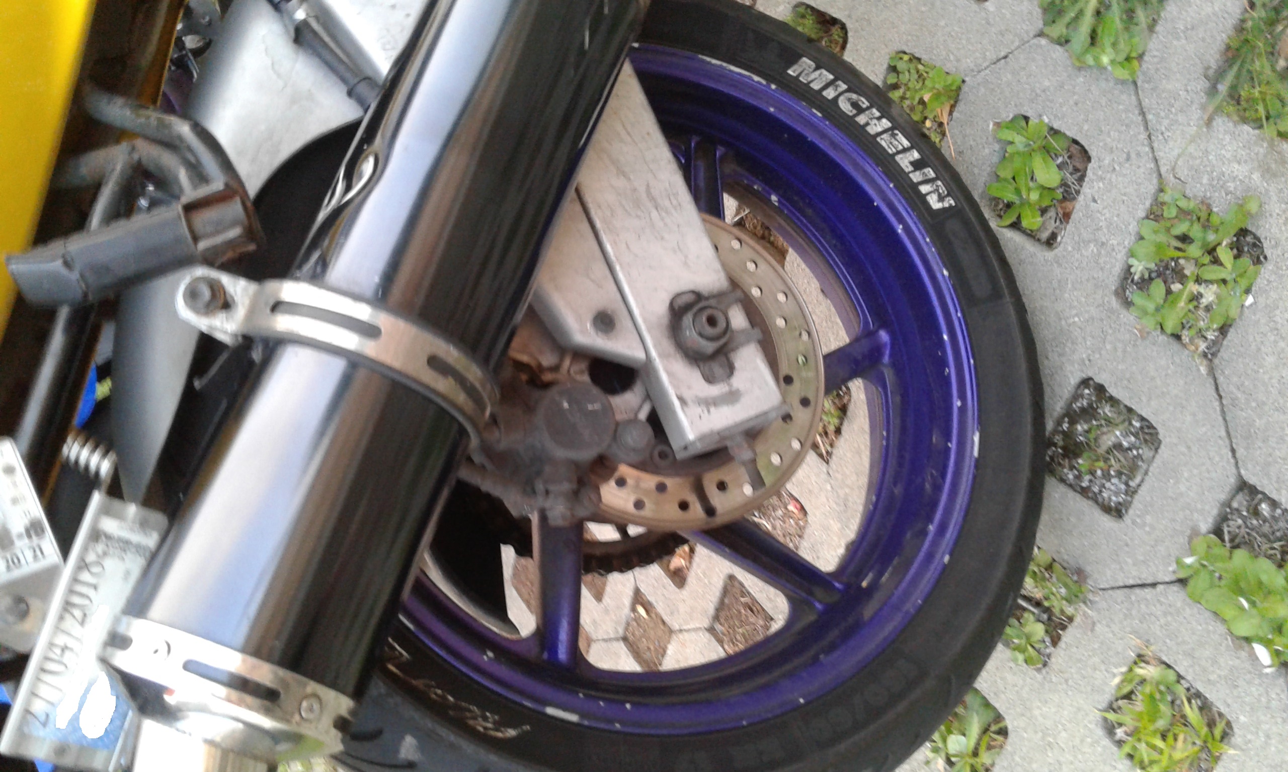

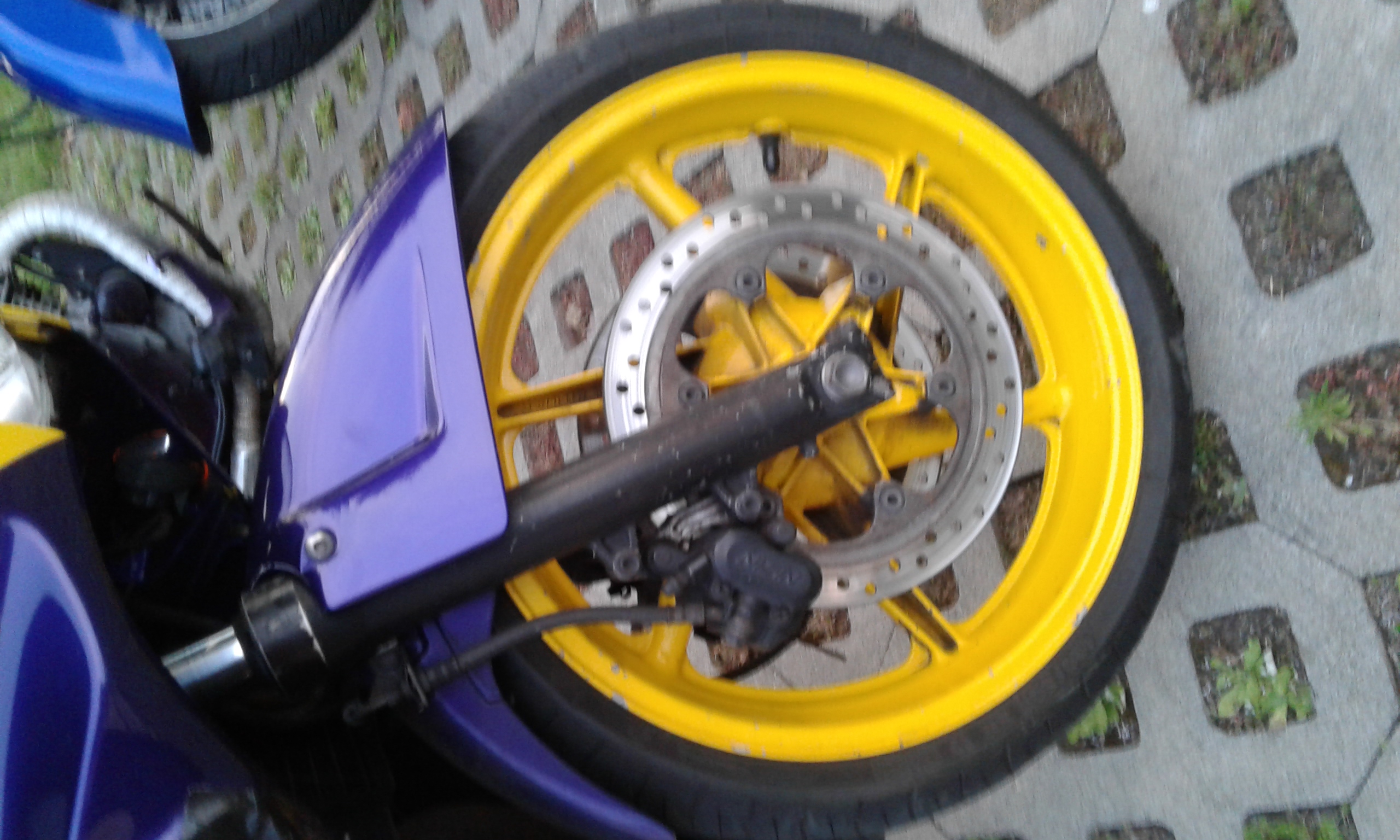

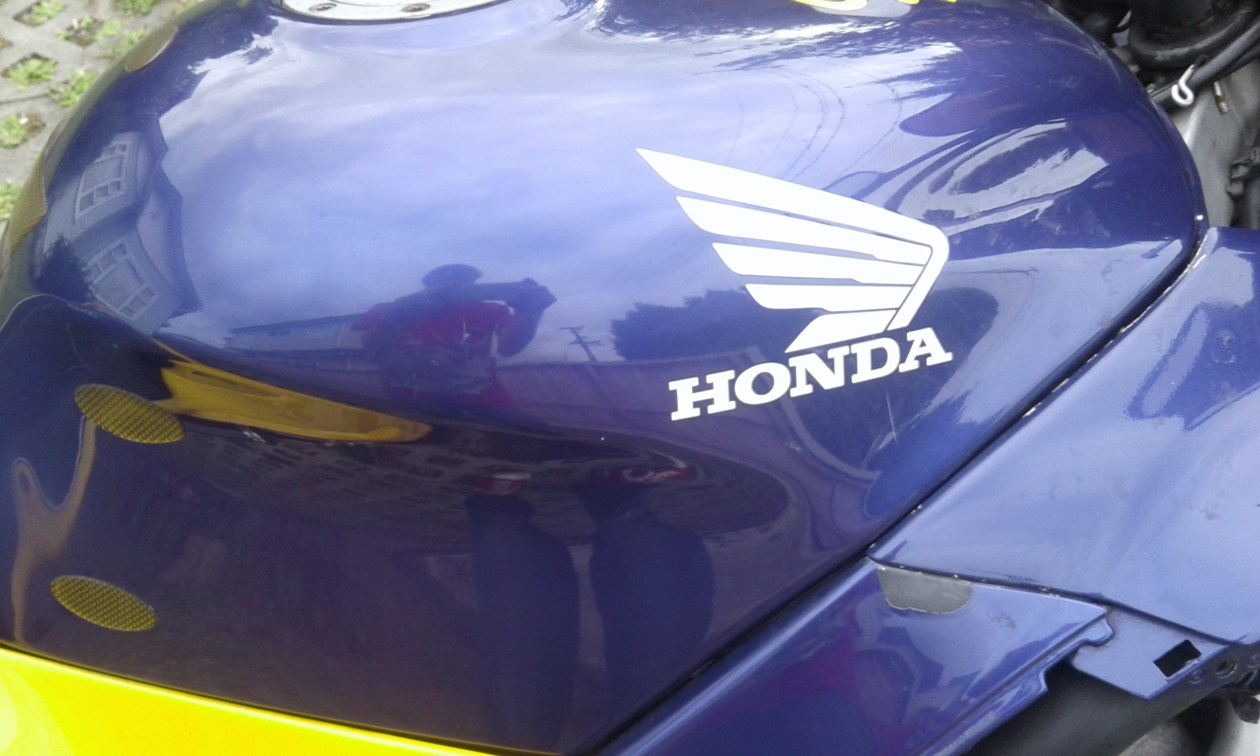

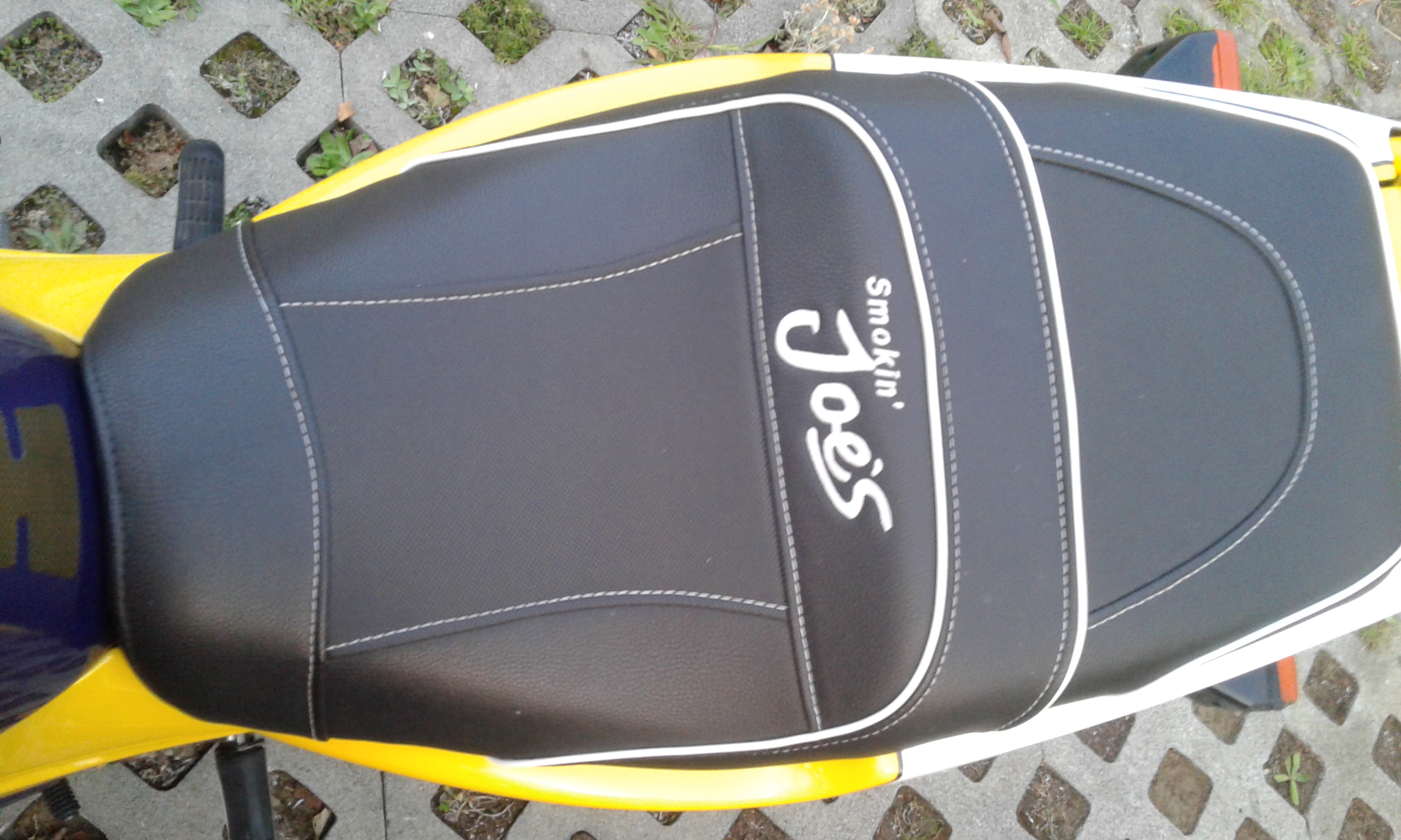

After a wash. I did a quick one before I went to the bike show. Can you tell lol? Seat is the nicest part of the bike.
Attached Thumbnails The resurrection of Smokin' Joe-20180304_195339.jpg   The resurrection of Smokin' Joe-20180304_195351.jpg   The resurrection of Smokin' Joe-20180227_164802.jpg   The resurrection of Smokin' Joe-20180304_195511.jpg

+1 for sorting out the mechanical before getting too far on those panels
Are you going to replace the tail as an assembly? ie subframe, seat, lights? Or are you going to try and keep that seat? Cause it looks pretty fresh
You might be able to dent out that tank with a studgun (or welded tabs) but if a decent replacement came up I'd hop on it. The filler piece on the right side fairing would be tricky to make from scratch, as would the filler piece under the headlight. The big gaping hole on the rt side of the cowl might also be tricky, but if I were approaching it I might try and cut out a patch from an old bumper or something to reduce the amount of filler. Might be a cute place to cut in a usb charger or cellphone mount
The great thing about plastic repair is that you can basically fix anything with enough time/effort. From the look of your other projects it seems like she's in good hands

Seat is staying for sure. I was hoping I could plastic weld half an F3 tail to the F2 - I'm guessing there's some filler work to get it nice? Will fiber glass if so or some plastic magic trickery if I can figure something out, sub frame and tail light. If I can't do this, I'll retrofit something else on and make my own mount for it. I'll get replacement panels for the air vent on the right fairing and headlight and if cheap enough the sides of the headlights too. Need to find a plastic welder, a soldering iron isn't going to cut it with the amount of filling and crack repairs these panels will need. Good idea for the usb, hadn't considered that.

I'd stay away from fibreglass for plastic repair. My bike was covered with fibreglass patches and I scraped most of them off with my fingernail. It's too rigid and will fail. Plus that matting is too thick for the repair material to penetrate
A lot of guys swear by the plastic welding, but I've never tried it. It's how they do remanufactured bumper covers though, so obviously it works well enough, and is basically invisible once you get good at it
I use flexible parts repair compound. It's how I was taught in collision. 3M Automix Easy-Sanding parts repair is about as good as it gets but pricey. We used to use it for everything from seam-sealing, to panel repair, to busted trim. It's a hack's best friend

Had some success with fiberglass and plastic. Temperamental, have to have no air bubbles, plastic sanded with 180 and then 240 grit. Too much and it will crack. FZR tail was still nice 5 years on but if the bike was dropped it would probably come away.
This time I'm plastic welding. Might stick with F2 tail, but add a new tail light, make a bracket for it etc. Brake pads and fluid flush and change top of my list, I've sidelined the CBR for now.
