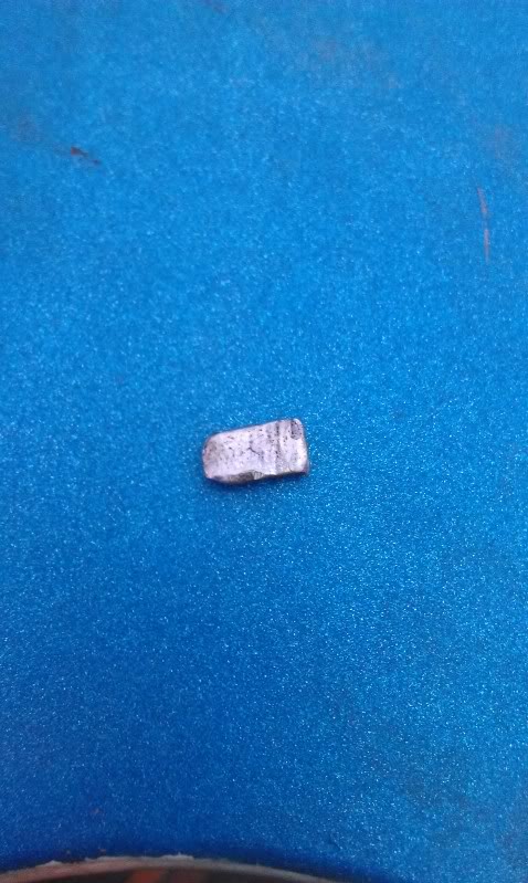

so i pulled the cover over the pulse generator. and i found this stuck to the lower pulse generator!
as well as the post for that side of the generator bent outward a little. so i made it perpendicular to the base and pulled the metal piece out. and put everything back together. and gave her a try!

good job getting it figured out man. any idea what that peice of metal is from?
