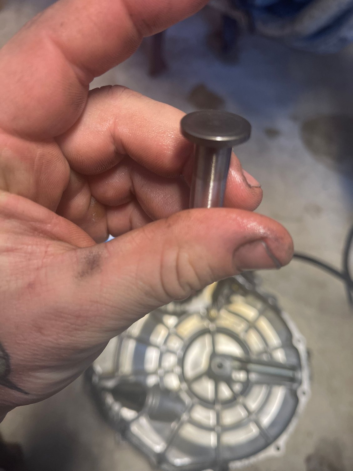

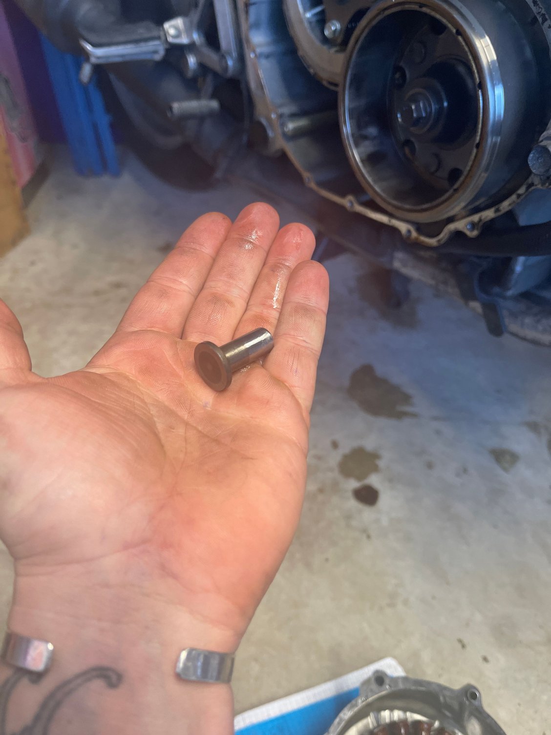

Hey guys I removed the engine case right side and I have a bolt dropped on the floor and don’t know where it’s from please help

Looks like the clutch lifter rod....

Your a gentleman
