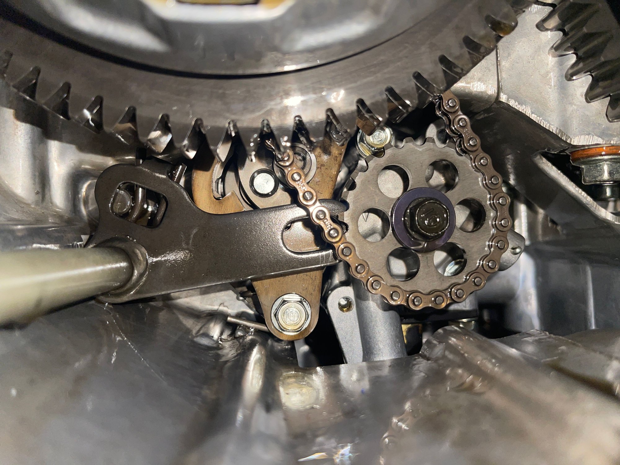

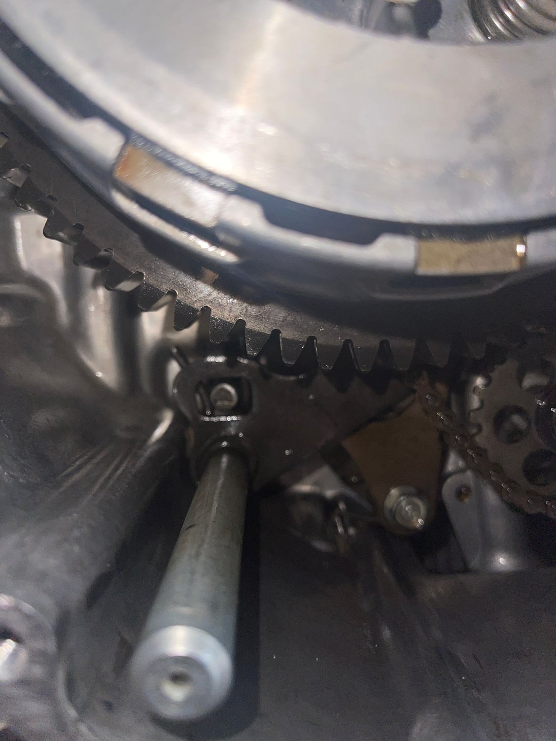

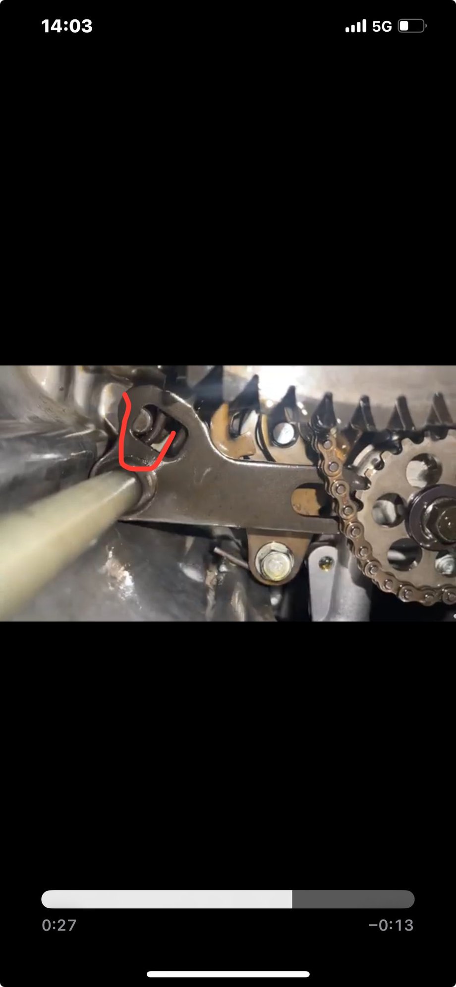

here’s a short video
the clutch side is open so you can see that it’s just limp , I’m going to open up the left side and hopefully it’s just the spring has broke and I can replace , however the brown bracket which is moving up and down is that ment to be moving freely ?

Yes, the spring (23) should be over the retaining pin (22).

So the pin should be in the middle?

Yes, to allow the spring to return the shaft in either direction.
