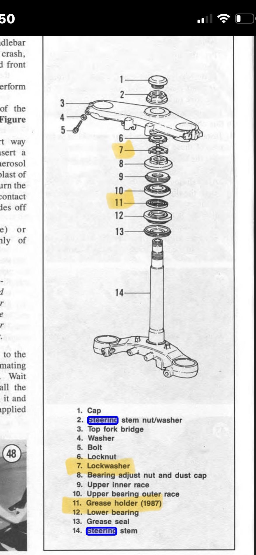

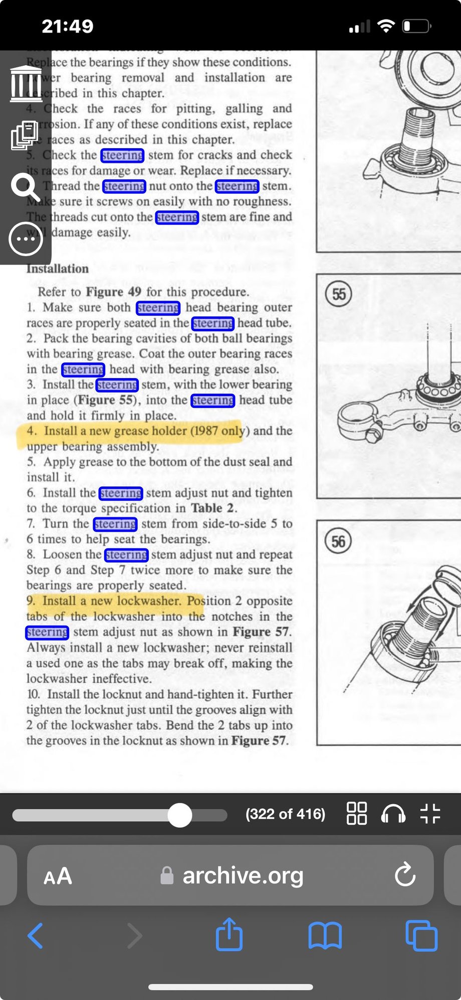

I’m just about to replace my steering head bearing, in the manual it says the replace the grease cover? Has to be the 1987, but I can’t find one anywhere so I just ordered a normal set of bearings but instead of the ***** they are the built in rectangle shape ones ? I also can’t find the washer for the bolt at the top of steering column , aus you must also replace but they don’t make them anymore and I can’t find them anywhere , I think you have to use a hammer and flathead to spin it so I hope I don’t damage it as I need to reuse 😫

did you reuse all of the washers and bolts from the steering Colomn? I can’t find a lock washer online and Honda don’t make he pry any longer
it says you need a grease holder, also couldn’t find but Ive ordered the tapered roller bearings instead
Sadly yes, as you've found they're not too easy to get hold of.
But if a shopping list but it’s my last job before I mot it and take it for a good run
I don't think my bike has a grease holder. I used a smear of grease on the outside of the outer bearing shell. Liberal application of grease over the bearings themselves.

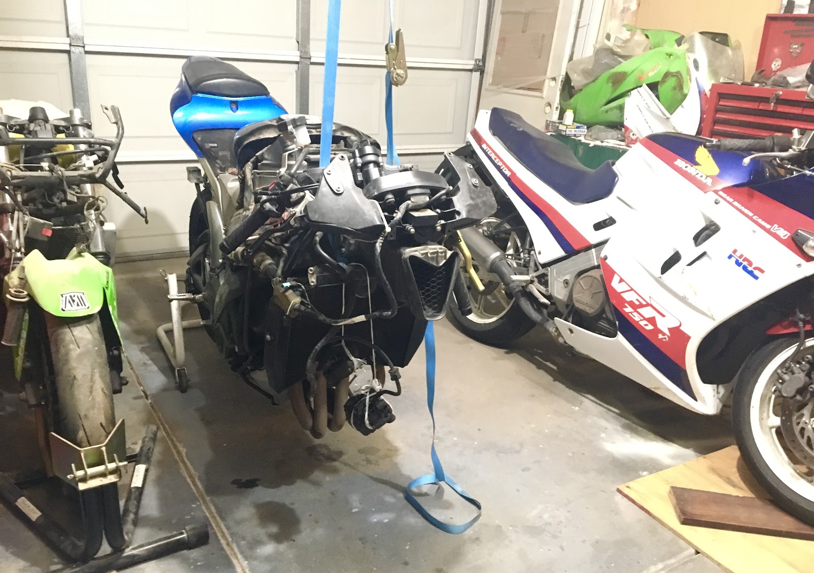

Nice one mate ! Yh I have a concrete roof in the garage so
i might drill in a ring and then hang the bike from it .

Yeah, I just hang mine from garage beams.
If you got tapered roller bearings kit, parts won’t match diagram because it’s not stock. Assemble parts in order shown in instructions for kit. Toothed washer on top keeps bearing adjustment cup steady while you tighten locknut. You can also use hook-tool aimed in loosening direction to oppose tightening spin from locknut.
