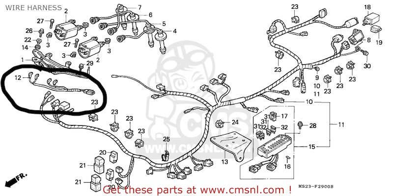

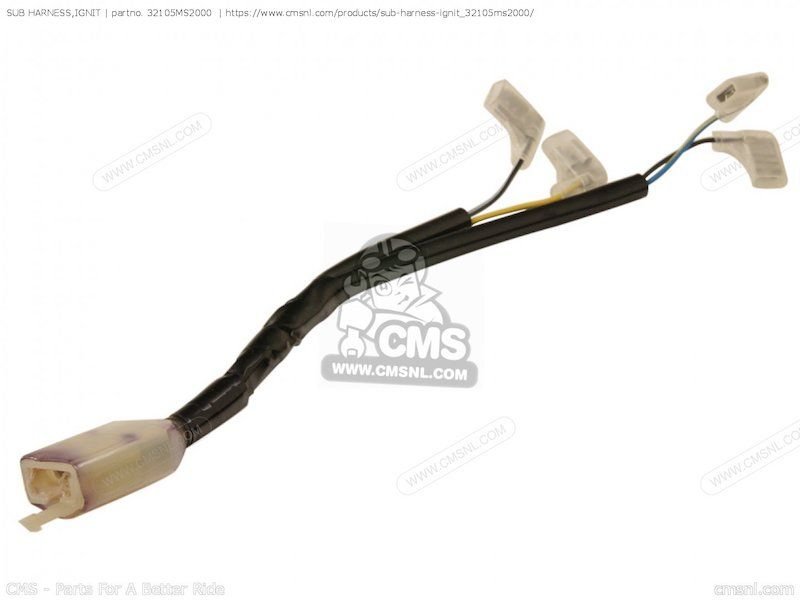

Wild guess....I'd check the connections here:
