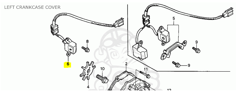

@mleanza There is a 4 Pin connector with only 2 wires in it. Should ohm out at between 460 - 580 ohms across the Yellow and White/Yellow wires. That's the only check.
Old Jun 16, 2022 | 07:31 AM
I did some looking, the dual pulse module was eliminated in 1989 and later. His definitely would have the single, item #6.
