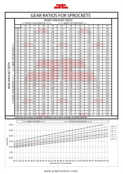

"Should I replace the sprockets as well?"
Oh man what a question.........but yeah I'd put new cogs on there as it
would be nice to give the new chain a virgin set to hang around with.
As for switching sizes -- see attached chart ......it pretty much says it all
I've found biggest usable front is 18 tooth smallest well as small as you want
but the trade off in smaller fronts is increased wear on it and chain.
That's one clean looking machine .....how many miles ?
Oh yeah stock is 17teeth front .........42 tooth rear (Ratio 2.47) 114 chain links
I'm running 18 / 44 myself (Ratio 2.44)for highway, but pop on a 16 /44
everynow and then to run the mountain twistys around here. (Ratio 2.75)
116 links needed for the 18/44 and 16/44..........so calculate links needed
before you go chopping your new chain toooooooo short

I run 17/44. It seems to give a little more pick-up than stock, but you give up a little when cruising. For example, in 6th gear, I'm running around 4kRPM at 70mph. I think I can hit about 65-70MPH in 1st gear at redline. Just FYI.
