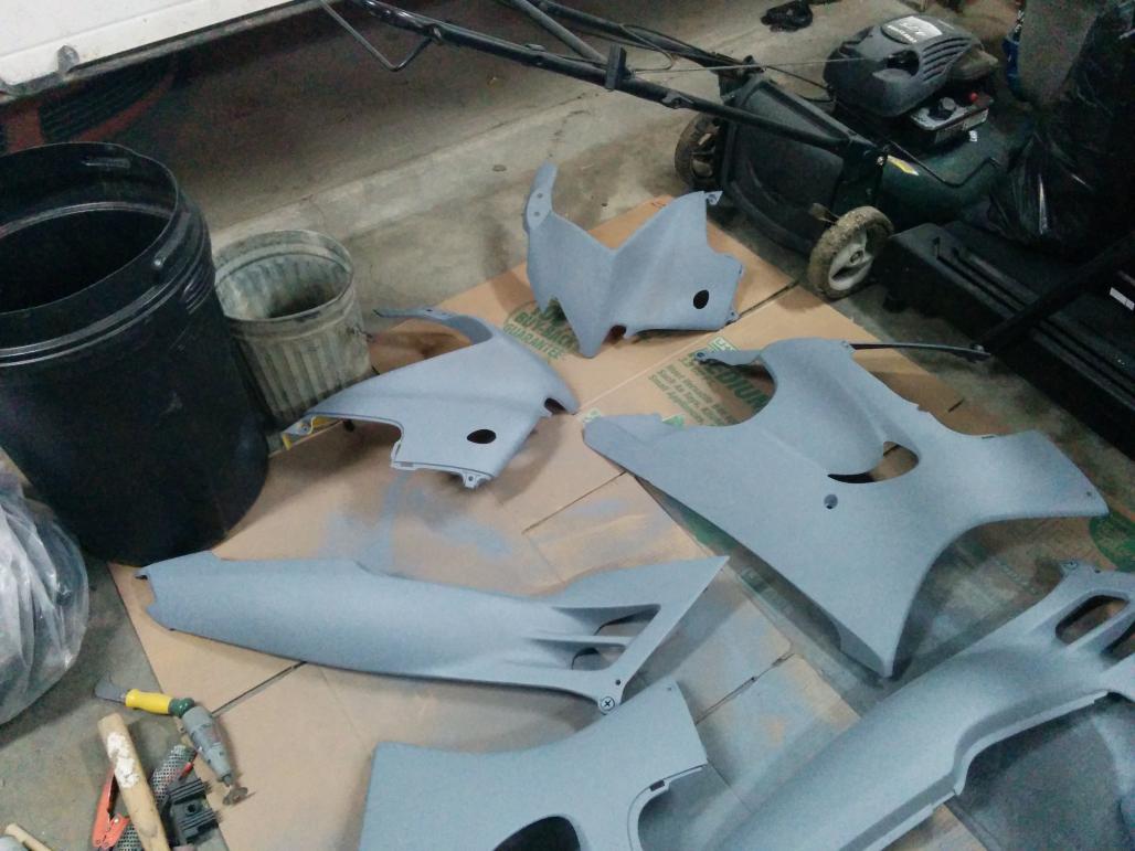

well i have started prepping all the fairings on my bike, but i have to wait another month or 2 for temperature to drop to suitable cure temp for bed liner.

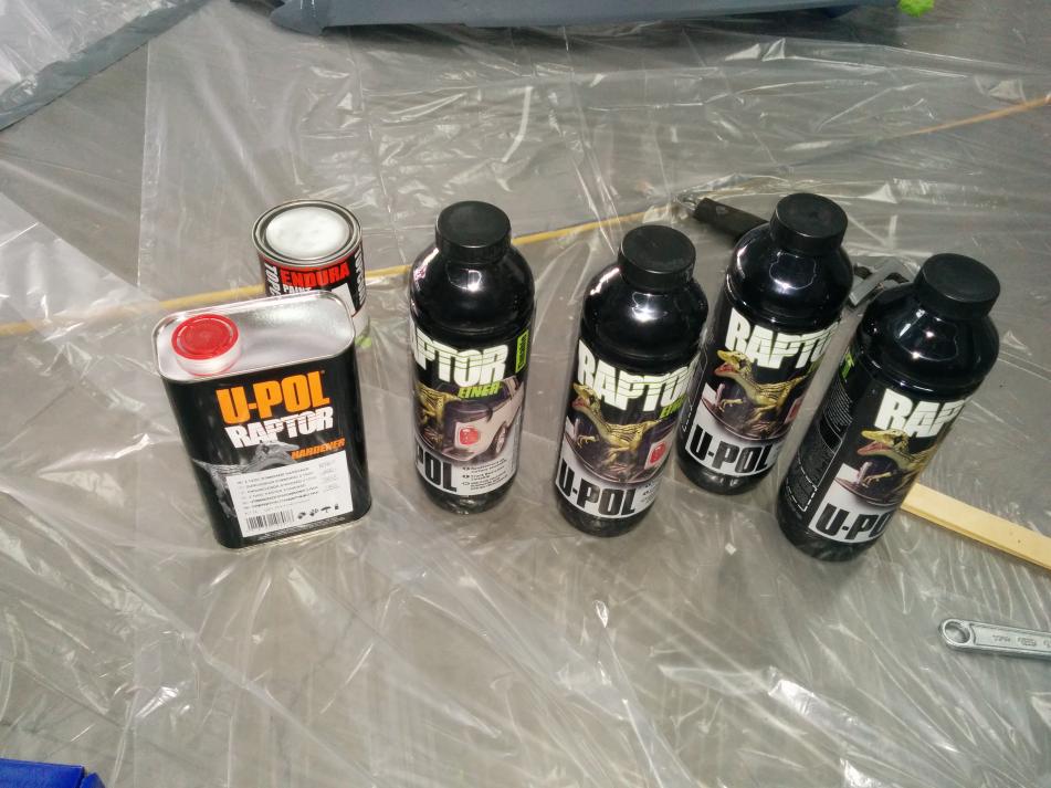

price:
liner kit - 150
schutz gun 20-80
etching primer - 20
bed liner is also much easier than paint, and of course more durable. with added structural integrity, sound dampening, heat resistant, and hard to scratch finish.

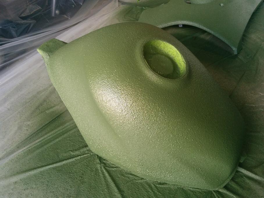

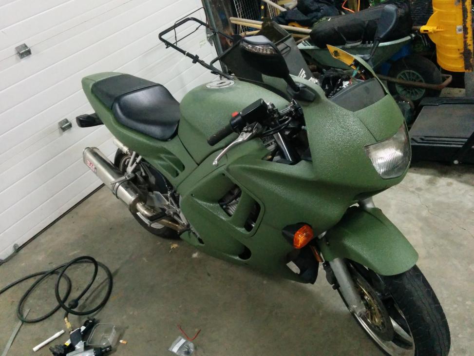

Default Finished it!!!!
HHHHAAAAAZZZZZAAAAA!!!
it feels so good to have this done!
I'm a bad procrastinator so its an epic victory on the new years resolution front...
Raptor liner is pretty good. I found the closer you spray the smoother the surface. Its not a perfect job but it looks good IMO...
I was thinking about adding some white "army font" lettering/wording.
