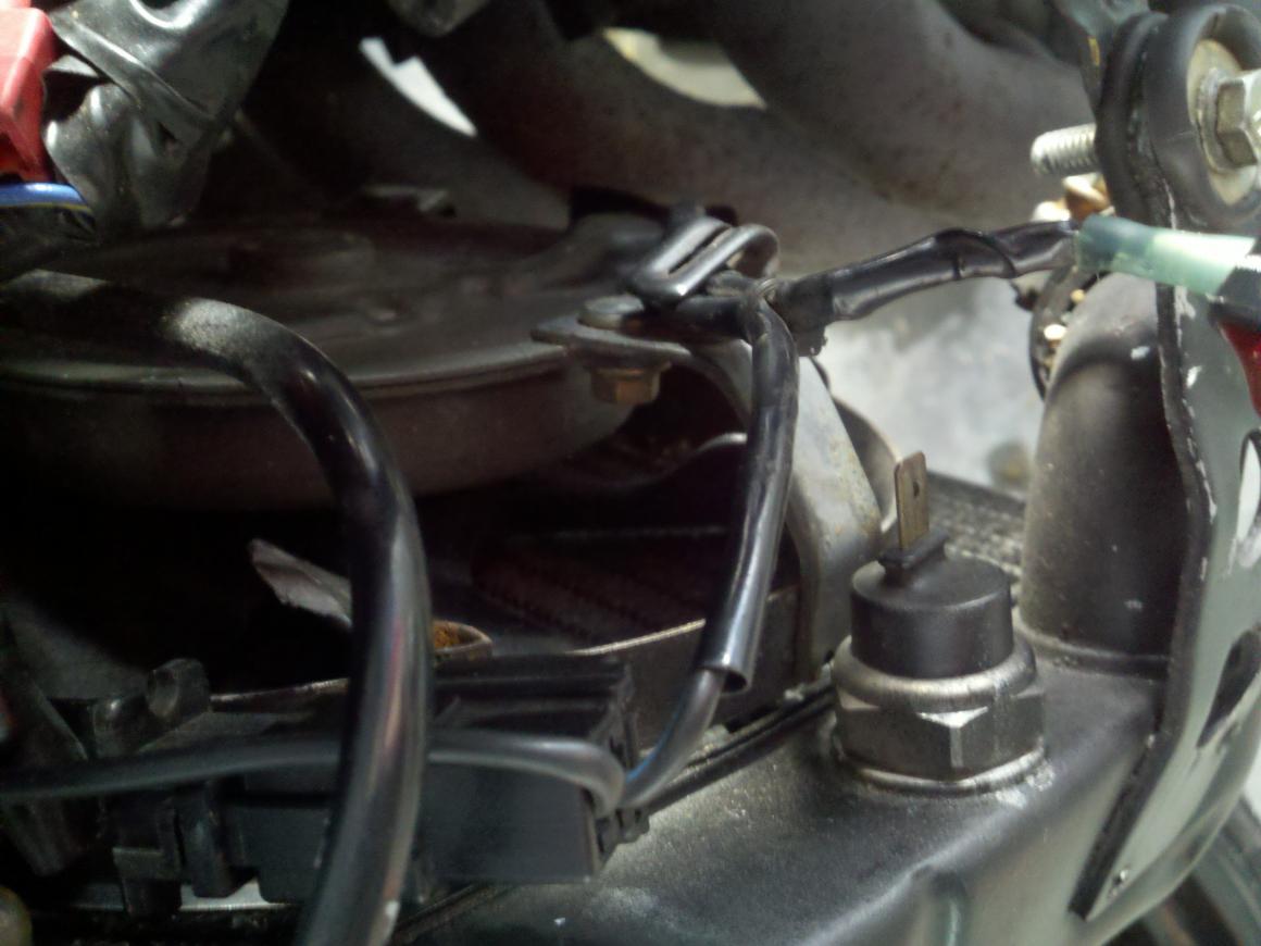

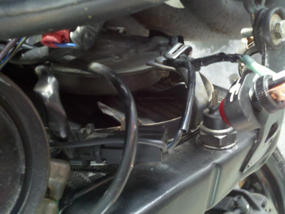

edit: I took some pictures of the wires/switch and stuff. There were a lot of tiny pebbles that blocked the fan from moving, so I cleared them out and it still didn't work.
anyone have any ideas if the wiring is wrong or something? There were only 2 wires going into the switch when I got the bike. A load and a power, no ground wire. and it worked without it. So, idk what happened lol
sorry for the pictures being sideways! they weren't when I downloaded them haha.
Wait, are you saying that the fan doesn't come on at all or just not with the manual switch? You could have verified if the old switch was okay by running a continuity check across the contacts when you switched it on and off.
If the fans doesn't come on at all see if you're getting power to the plug at the fan. If not, then make sure the fan fuse is okay.
Well, I haven't really run it hot enough to see if the fan turns on. It's been too cold to ride haha. I bought a new switch because the old one was getting gross anyway. Only $2 at radio shack.
I'm assuming the plug at the fan are the wires directly connected to it?
and I'm unsure if this is important or not, but on the bottom left corner of there radiator there is a plug just sticking out with no wires connected to it. I don't recall anything being there before, but it looks kind of like something was plugged into it before. You can see it in the picture.
