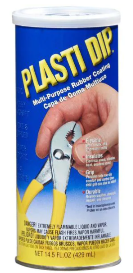

What about using something like this? Not sure what colors it come is, but if the underlaying metal is ok and it's just the coating, I think it would work.

Top find! Never knew this product existed. I've contacted them regarding resistance to petrol, though it's probably OK, and they even have a UK address.
Cheers.

Boy, then you're in for a surprise. People paint their cars with this stuff. When you don't like it anymore, you just peel it off. Naturally its not as thick of a coat that you're wanting to achieve, but essentially the same.

I saw that. Who'd have thunk it ......... Their website shows a push bike getting done as well. Maybe I'll do the car in bright pink or something whilst the wife is out ... though maybe not - I want to see out the next few years in reasonable health ...
BTW: they got back and said that petrol should be OK if wiped off reasonably quickly but would degrade the surface if left. Should be fine then.
