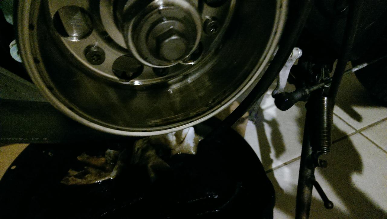

You really cannot tell from a picture, can you take the plugs out, remove the flywheel and crank the engine over to see if it wobbles or is the starter motor cogged to the flywheel? One telltale sign is usually that the seal might start leaking. Basically the only way to be 100% sure is explode the whole engine and take the whole shaft to a shop to be measured, but I'd suspect if it had gotten a hit you could see it by turning the engine over.

Another update on the F4i. Sadly after a few months of minor riding I noticed that she started to leak. I checked around and could not find where is was coming from. Finally, narrowed it down to the stator case. The leak was not huge, just a couple of drops here and there but non the less A LEAK.
I was hoping it was just loose bolts, but nope. Removed the cover to check the gasket and noticed that the flywheel had some scuff marks from the stator. Turns out the crank was bent, ever so slightly and the leak was from the cover not sitting a 100% flush. I am on the hunt for an engine now. Its scary not knowing the condition and history of all these engines on Ebay.
