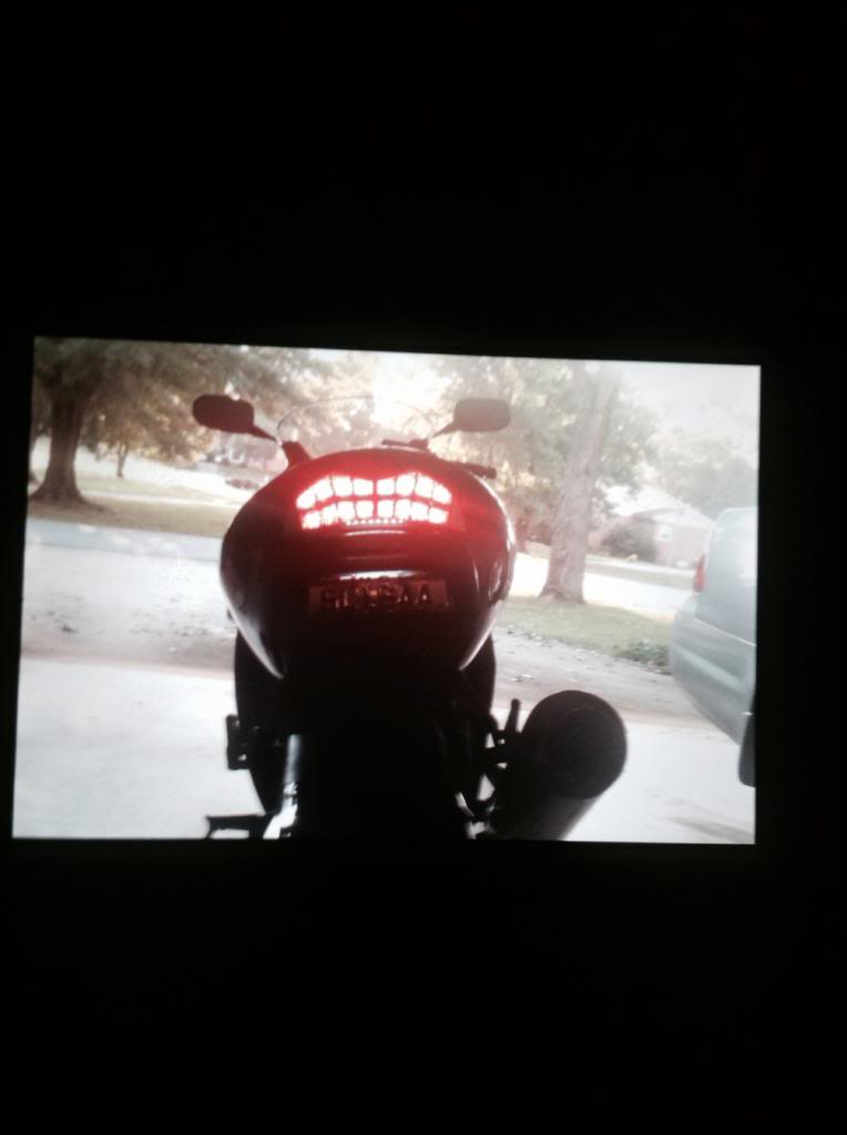

Installed my new LED taillight! Flashing brake light that goes steady after 2 seconds mad includes sequential turn signals like the brand new Mustangs. Had two comments in the first 10 mins around the neighborhood. Love it!
