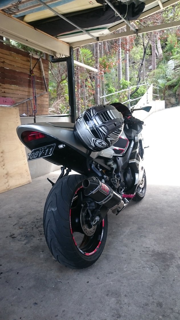

So i finally got round to getting a few more jobs done on ma Pup over the last week or so.
Put on a Kodaskin tank protector and fuel cap cover.
Cut out some Techspec C3 grip sheets.
Resprayed rear wheel and put on rim tape and wheel decals.
Fitted new carbon fibre 'Yoshi' tri-oval shorty exhaust.
Resprayed the foot-peg brackets/heal plates.
Fitted new foot-pegs/gear lever.
Fitted a heap of new fairing/frame bolts.
Adjusted the front/rear suspension to firm it up bit as it was feeling a bit sloppy.
Just got stainless braided brake lines to do - and the suspension tuned/set-up but as thats looking like being fairly expensive (AU$1800) for K-Tech internals, spring/valves/shimmed etc i have to think about how long I'm keeping ma Pup for.
But it's looking/sounding/riding very nicely.
. Techspec C3 grips sheets cut to match tank decals
Kodaskin tank protector/fuel cap cover, rim tape
Carbon 'Yoshi' tri-oval shorty
