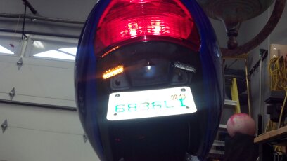

Ive been searching for custom fender eliminator kits that people have made and I have only been able to find a few, I decided to attempt to make my own yesterday and it turned out better than I thought and makes the bike look 10x better. I figured I would post it up for other people that are looking for ideas.

Cut the plastic which ever way you think it looks best and sand it down, I used a dremel tool to cut then 400 gritt sand paper to make it smooth, mount the license plate, and stick the LED strip on the bottom of your brake light ( I left a few extra inches on the wires for the led strip so if I need to remove the rear fairing I had enough play to move it enough so that I could get to the plug) And this is what it will look like when your done.
