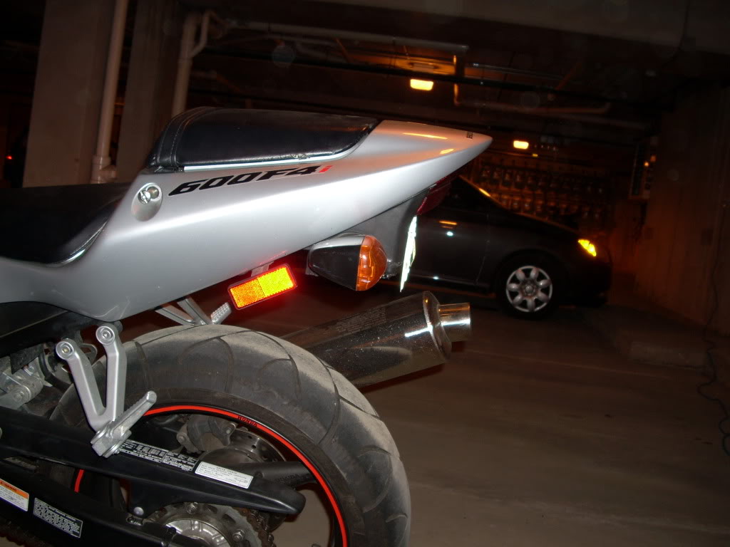

Well, I did it. I hacked off my fender. Here are some pics.
Before:

Finished product:

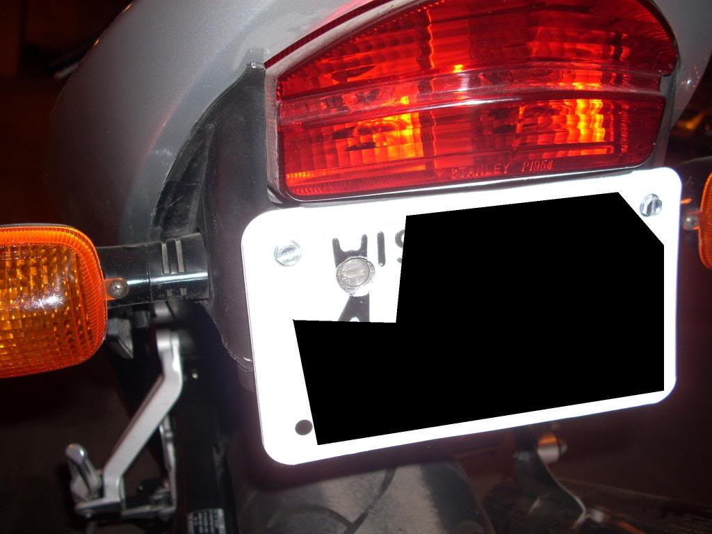

Key hole cut into plate:

I am VERY happy with it overall.

Uniqsol, you really went the distance with this one!
Thanks for all the great pics and video clip.
Have you thought about removing the reflectors on each side right near the directionals? I did it and it sleeks it out even more-they're rivited in there so you have to drill them out.
Looks gret, what are you going to do with the wiring that hangs down from the blinkers?

The reflectors and factory stickers dont really bother me. I might take them off one day if/when I think they need to go. The wiring for the signals isnt really any more exposed than they were before. I may just try to get them to hang tighter against the underside of the bike.
As for the wiring that went to the plate light, I just insulated them and pushed them up into the hole they came out of...I figured if I do get hassled for not having plate lights I would like to have the wire available to put some LEDs over the plate.

Super easy.
All you need is a dremel w/ cutting and sanding accessories, a drill w/ a 1/2" bit (for key hole) and a piece of paper to make the template for the plate.
Also I used a silver sharpie to make the general guide line that I wanted to cut at.

Yea man, you should tuck those wires up....or maybe not hack so much off to conceal the wires.
