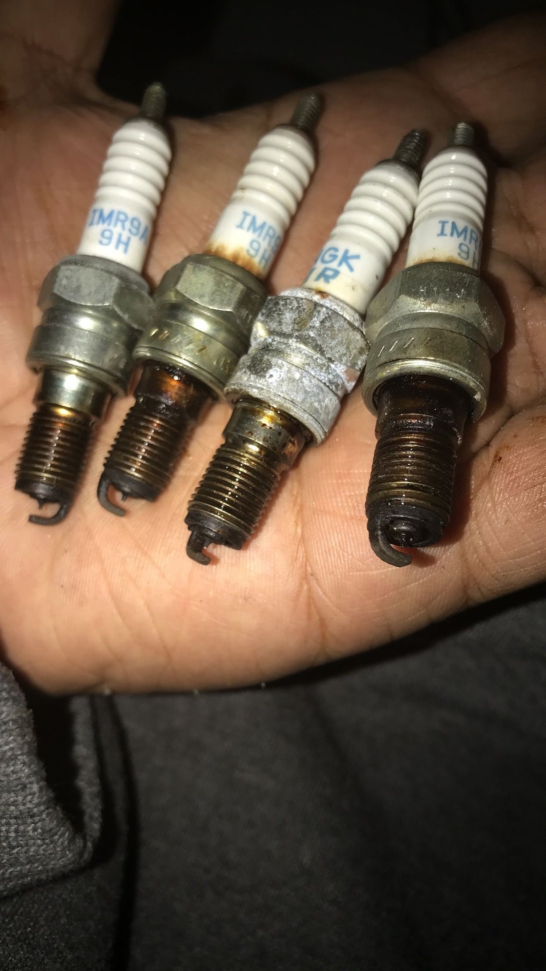

Old Nov 28, 2017 | 06:53 AM
  #48
Posts: 7,179
Also one way to tell if it's a spark plug socket, it should have a black rubberish insert inside the socket. This insert holds on to the plug after its been screwed out all the way until you get it all the way out of the well.
There are 2 basic spark plug socket sizes, 5/8 and 13/16. I'm pretty sure you need 5/8.
Old Dec 2, 2017 | 03:25 PM
  #49
ZayTheeDon's Avatar
Joined: Nov 2017
Posts: 46
Originally Posted by CaBaRet
Then that spark plug socket will fit
are they bad
Old Dec 2, 2017 | 05:31 PM
  #50
ceebeeaarguy's Avatar
Joined: Nov 2016
Posts: 215
From: Dorset
Yes. An engine in good health will have nice copper brown plugs. Yours are a bit sooty meaning rich fueling mixture. But I am more worried by the oil residue I see on them. Did they have oil on them or the camera flash is confusing me? You have reams of internet pages written on how to read spark plugs(don't have to be motorcycle specific), look them up.
