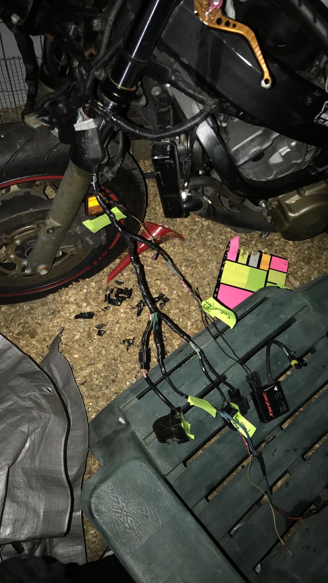

Hi where's the connection to the bikes harness, could you lay the whole thing down and take a picture
This is last pic I took of the front harness but what I did was remove the ballast on the right and just tried connecting the new wires to where the old ballast wires went blue and green in this case

Hi the kit you got should have been plug and play, I would go back to connecting the Harness that came with the kit and go from there
