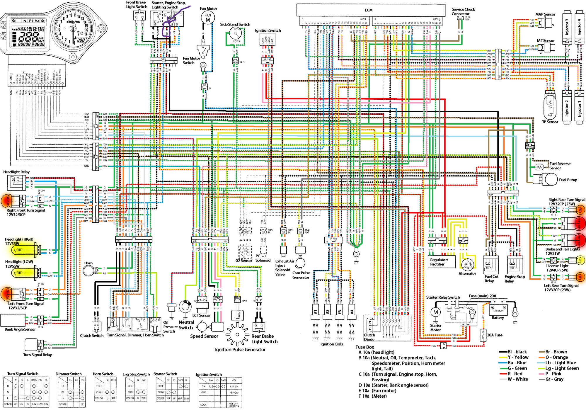

Thanks for the advice, so the issue ended up being the soldering from the wire to the connector in the ignition switch had become undone. Either due to the vibrations or high current draw through the wire. I'm not sure and my rear tail lights were also blown out. Soldered it back down and got some new bulbs for the rear and its all set now. Thank God for making it easy to find! All in all did it in less than about two hours. Not sure why I couldn't find it before I was having a really hard time pin pointing what it was but after reading your message I went step by step and notice the light switch wasn't sending the signal to the screen that the high beams were on so I knew the fault had to be before that part somewhere. In the image below I marked where it had became undone. That is the 2006 CBR600 F4i wiring diagram.
