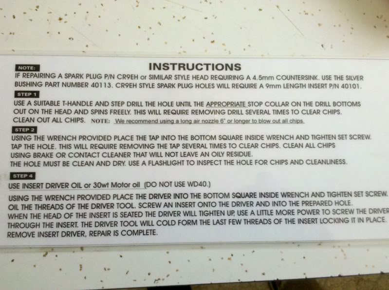

Yup, the kit is specifically for sportbikes that are M10x1mm, and it's the extended one because of how deep the access hole is for our plugs. Here is the kit so you know what you're getting into:
Since it's already been coiled by the previous owner, the drill part will barely be removing any material. You'll be able to drill it by hand and the important part is getting a nice seat for the lip of the insert. I'm sending a PM for details to get the thing from me as well.
