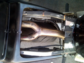

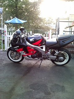

my bike is a 95 production year. yet it has like '97 or something fairings, and different head lights and stuff.
it actually looks pretty nice. black with red . tucked in twin exhuast that runs under my seat and out the rear fairing u barely notice it.
pics soon

I would like to see a pic of your bike with that exhaust....sounds really cool!!

i want to see that exhast too....changing out the stator on that bike is not to bad either, i did mine in less than an hour...peeece

here some pix of my nightrider
Attached Thumbnails need some help....stuck over here!-get-attachmentaspx1.jpg   need some help....stuck over here!-get-attachmentaspx2.jpg   need some help....stuck over here!-get-attachmentaspx3-1-.jpg   need some help....stuck over here!-get-attachmentaspx4.jpg   need some help....stuck over here!-get-attachmentaspx5.jpg
