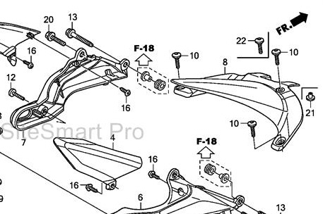

I really really think it is the hugger that causing it. I wonder if I should get another one since it is pretty cheap. Maybe they sold me some other year not 09.
Bolt # 21 and 22 do not go with hugger, right?
I am missing the "collar". That's why it keeps making the noise.
Old Apr 2, 2011 | 02:34 AM
PlayfulGod's Avatar
Posts: 6,026
From: Dalton, GA
yup tats prolly it, so the hugger isnt really tight, just held on by the bolts so you hit a bump it bounces a lil.

Try and take the hugger off and ride to see if that fixes the problem. If it does not make that noise any more then you know its the hugger. When you put if back on make sure you have the collar or put some rubber washers inbetween the screws and the hugger to see if that helps.

Problem
In that pic above, how do you read it? do you need just 1 collar or more? The dealer sold me 2, but I first installed just 1, then it was still making noise. So I put 2, one in the back, and one on left side. noise is much less. But I still hear it on right side, so I got another one and proceed to install on right side. Right side has brake hose guide thing, so it made the hugger bit higher, and yesterdat my pipe hit and melted a small potion of it again.
Now I look at the pic, I think I was supposed to make sure that little edge on that hose guide thing is supposed to go into a little hole. I will look at that before I ride this morning and see . Maybe that is making the noise.
In the mean while, I took off the collar from right side.
