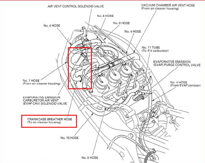

Originally Posted by lupeavocado
Update: The bike died on me 30 minutes into riding yesterday, the engine started chugging and then died. I thought it was because I was only riding it in first the whole time and revving high rpm's. Tried to ride today and it was running fine for 40 minutes, shifting gears, taking my time...until I dropped it. After the drop, some fluid started leaking, but it stopped once I set the bike upright. I tried to figure out if it was gasoline or oil, but couldn’t be sure. I traced the leak back to the crankcase breather tube and assumed the drop caused it to spill.
When I turned the bike back on, it started running hot, so I shut it off. Now I’m not sure what my next steps should be. Any advice?
Hi mate I see that I am a bit late but still wanted to check in🙃. So If you tipped it over and a little bit of fuel could have gotten into the hose that is definitely possible. This can cause your air fuel mixture to be dirty and improper, which can cause it to overheat. If I was you I would check if my air filter is contaminated and clean out the airbox good. Try it again. And come back here if the problem still appears(keep in mind usually the simplest solutions are the right ones)
