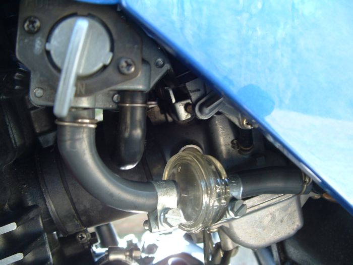

Trick to converting to gravity-feed is to shorten hoses as much as possible. And keep hose-run as vertical as possible without any downward loops where fuel has to go uphill to reach carbs.
Here’s an example. Short with no down/up sections. Maybe just 5” of hose between petcock to carbs.

Originally Posted by dannoxyz
yeah, just leave pump & relay as is.
