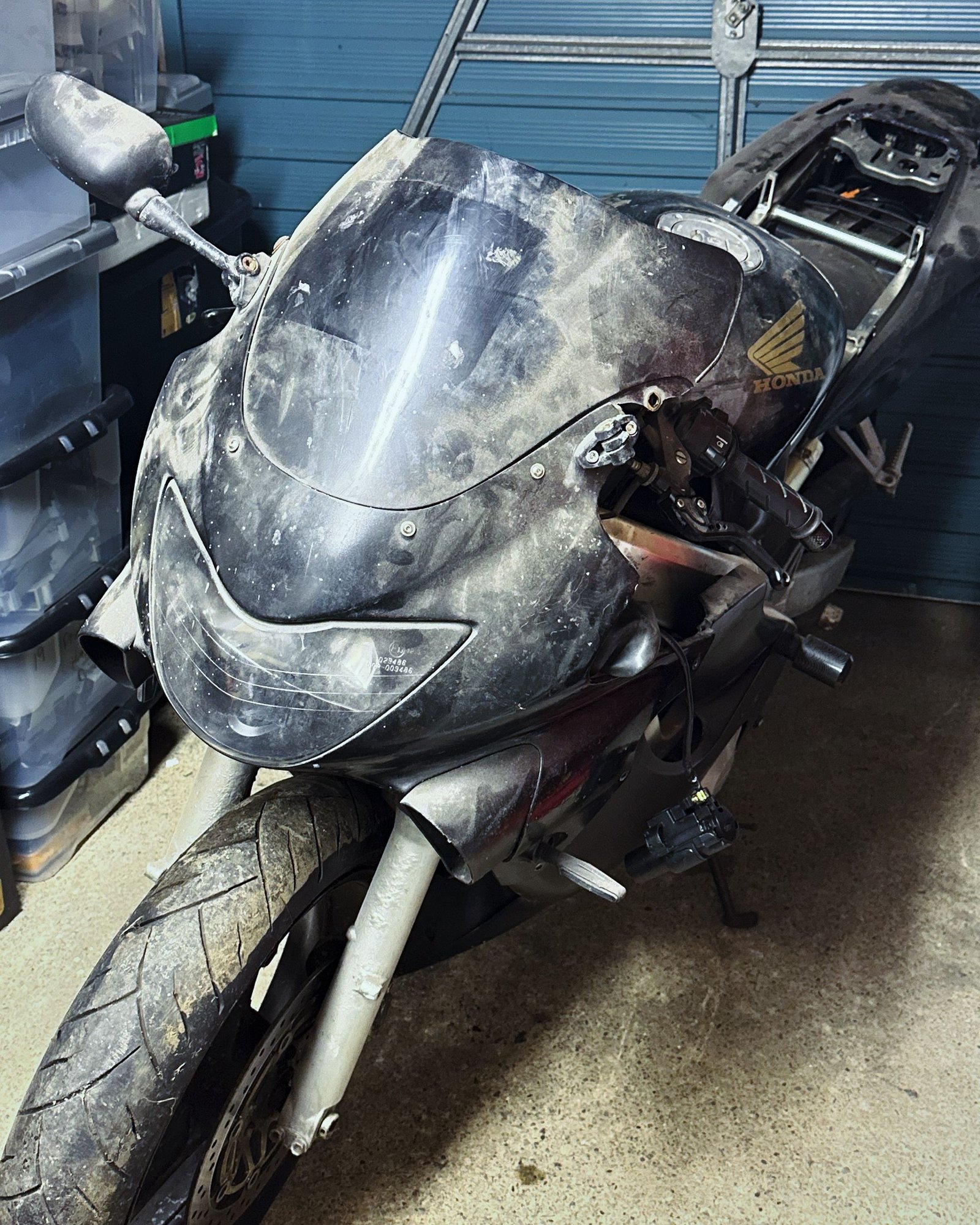

picture of the bike when it first arrived 😅
