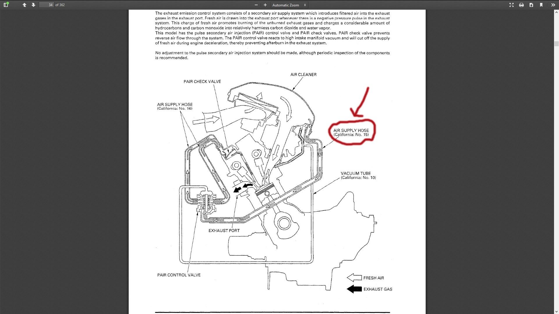

Old Apr 10, 2019 | 12:23 PM
Here2Ride's Avatar
Joined: May 2018
Posts: 45
Circled in red is what was the disconnected emissions line when I bought the bike, whether or not it was intentional or not I dont know, but I noticed it when I was installing the new stator so I reconnected it. Did my new problem start around that time because of it or just a coincidence? Not sure but I re-disconnected it and will find out next time I take the bike out. Im not sure what else to look at when you mention to "look at DAI (which im guessing is direct air intake?) and solenoid" Thanks
Old Apr 10, 2019 | 11:41 PM
CaBaRet's Avatar
Joined: Oct 2016
Posts: 2,519
Likes: 8
From: Lancs ,UK
Yes that hose should be connected, if a Cali bike, but you should be looking at the normal Air side and solenoid,changes the Air flow from 20mph ,tests for checking the solenoid and relays are in the manual page 5-36
