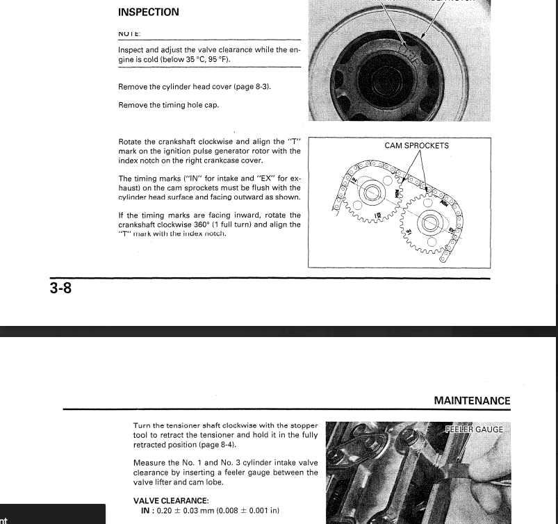

I have the crankshaft rotated and IN + EX lines are aligned with the top of the head and index notch is lined up with the ignition pulse generator rotor.
My question is on the second page it asks me to turn the tensioner shaft clockwise and hold it fully in the retracted position. I have a manual tensioner on mine and no longer have the junk auto tensioner. Do I have to back off the tensioner in order to check the valve clearances or do I leave it tightened up? Do I have to retighten it when turning the shaft to check other cylinder's exhaust and intake valves or can I leave it retracted? I tried to check the clearances on intake valves for cylinder 1 and could not fit my gauges into it from the top end. I could do it from the side for the LH intake valve but not the RH. I would like to do this job correctly and would appreciate constructive feedback on what I could be doing wrong and/or what else I could do while I have the bike torn apart.

From my understanding from this thread and of the manual, once I line up the IN and EX marks with the top of the head and the T mark on the rotor with the index notch on the cover, I am to retract the locking nut on my timing chain tensioner and release all tension on it?
Then from there I can follow the manual and turn the crankshaft as needed to measure all intake and exhaust valves clearances?

Unless specifically mentioned I do not see any reason for releasing the tension as the valves will be clear of tension when crank rotated
Thats what I was thinking.
I'll probably measure my clearance, but may skip adjusting at this time. May be out of my depth on this one.
