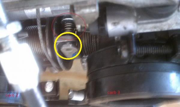

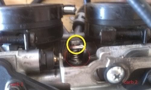

ok, just looking into that area with a flashlight, i'm fairly sure i have my spring in the wrong place, here is your picture with where i believe my spring is, would this incorrect position explain why the throttle wheel isnt returning all the way? i detached my cables and used fingers to pull it open to see if it would snap back correctly and it only goes about 3/4 of the way back, if i want to return it completely i have to press on it to go all the way in. should i go ahead and take the carbs back off to get a better look? does it even make sense that i could have gotten the springs in that position?

okay i took the carbs off (again ) and took a couple pictures of how my springs are....i believe that the last picture ( spring between 3-4) is the only one set correctly? please help i am getting sick of carb work lol
spring between carb 1 and 2
spring between carb 2 and 3
spring between 3 and 4
also, do i have to take the carbs apart to move the springs or is it possible to get them out with the extra work?

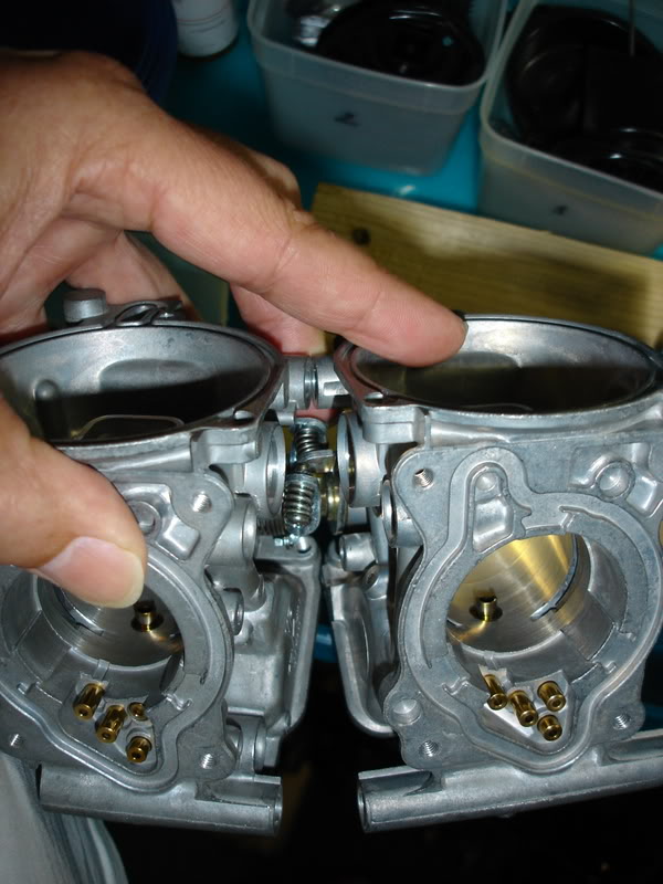

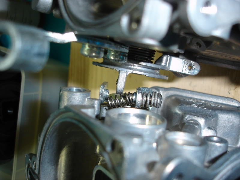

Sorry for the long delay in my response (life just gets in the way sometimes). Anyway, I don't recall why I chose that particular picture, but there are 2 springs that go in between the carburetors. They should look something like this. I'm holding the carburetors apart so you can see them clearly. With the carburetors together, the springs are inline with each other.

The upper spring in this photo holds the tab (that is coming off the carburetor on the right) against the adjustment screw. This is the synchronization screw. It appears that you're missing springs that go between Carburetor 1 & 2 as well as between 2 & 3. This would definitely cause unusual idling problems.
You're missing a couple of springs, one on each assembly. I've circled where the missing spring goes in yellow. Without these springs, you'll have no way to adjust the idle speed or get them synchronized at all. Upon closer inspection and comparing with mine, it's not that you're missing the springs, you just have them in the wrong place. If you look closely at the tabs where the springs sit, there is a small little bump on the surface that prevents the springs from sliding off the tabs once they're installed in the right position. The adjusting (synchronization) screw tip should come in contact with the tab of the adjacent carburetor. The spring then holds that tab firmly against the screw. I hope all this makes sense. The way the springs are installed right now, the spring is holding the tab away from the adjusting screw. It is possible (not difficult at all) to install the springs without separating the carburetors from each other.

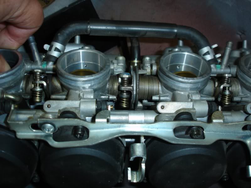

Here is a photo from a spare set of carburetors I have that show's all the springs in place. (I don't want to hear any crap about how dirty these carburetors are, they haven't been cleaned yet... ). At least you can see what they're supposed to look like.

Thanks for the reply dirt, I did install the springs in the right place when I put the carbs back on this time, I haven't tried to start it because of the gas tank situation (see above post) but just by moving the parts by hand I can see how moving the parts it has made all the difference, I'm extremely confident that this along with my throttle cables soon to be installed correctly my idle issue is all but fixed.
