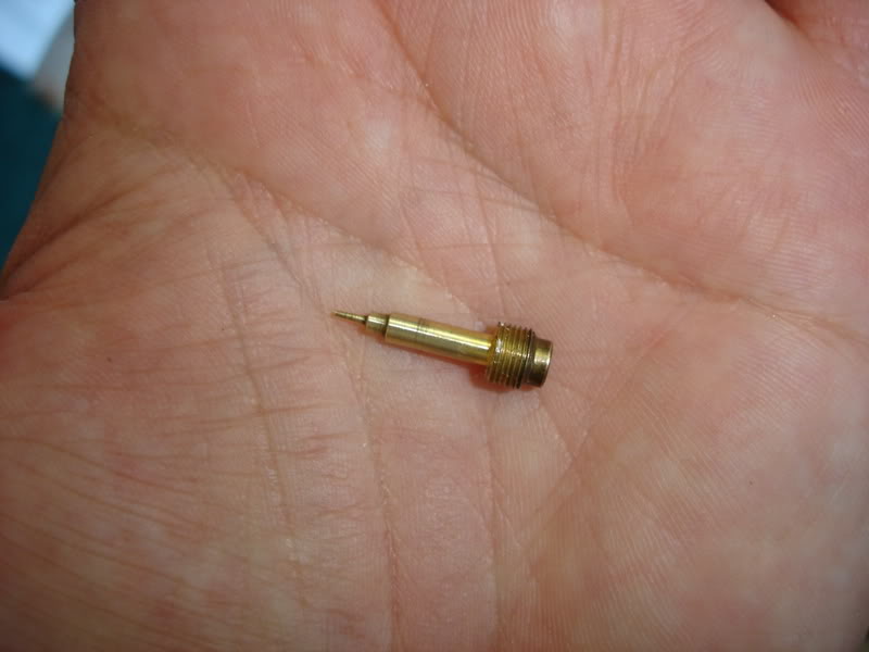

No time now, but I'll post a photo tonight of what the Pilot Screw looks like when it's out, close up. There is a spring, an "O" ring and a washer on it.
Here's the photo I mentioned. A slot is not going to hurt it at all. Remember to turn them in until they stop so you know how many turns out they are.

1 vote for paranoia
You'd only be notching the pilot. Not cutting it in half. And assuming you're doing this with the carbs off (since you kinda have to), there's always compressed air for whatever microscopic shavings the dremel creates

thanks. yeah carbs are off right now. looks like i'll be notching them.
